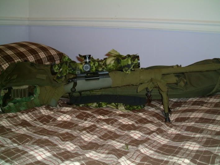

I am also going to try and see if wrapping the grip area of the stock with some fabric might work. I have a huge load of fabric strips from Dropzone that I will bring and see if wrapping it tightly (kind of like WWII era rifles) around will be what he wants. Plus he can interchange the fabric types and designs as I have a good collection of scraps from the cutting room floor. (pounds of it really)
I actually wrapped some around my gun in parts and I love it. Makes it more comfortable to carry and feels great grip wise (kind of like hockey tape but a little bit softer)
only worry is what it would be like a little wet. It is easy to remove if that is the case anyway. Plus I was extremely careful to wrap or tie it in such that in no way does it interfere with the use of the rifle or its shooting ability.
