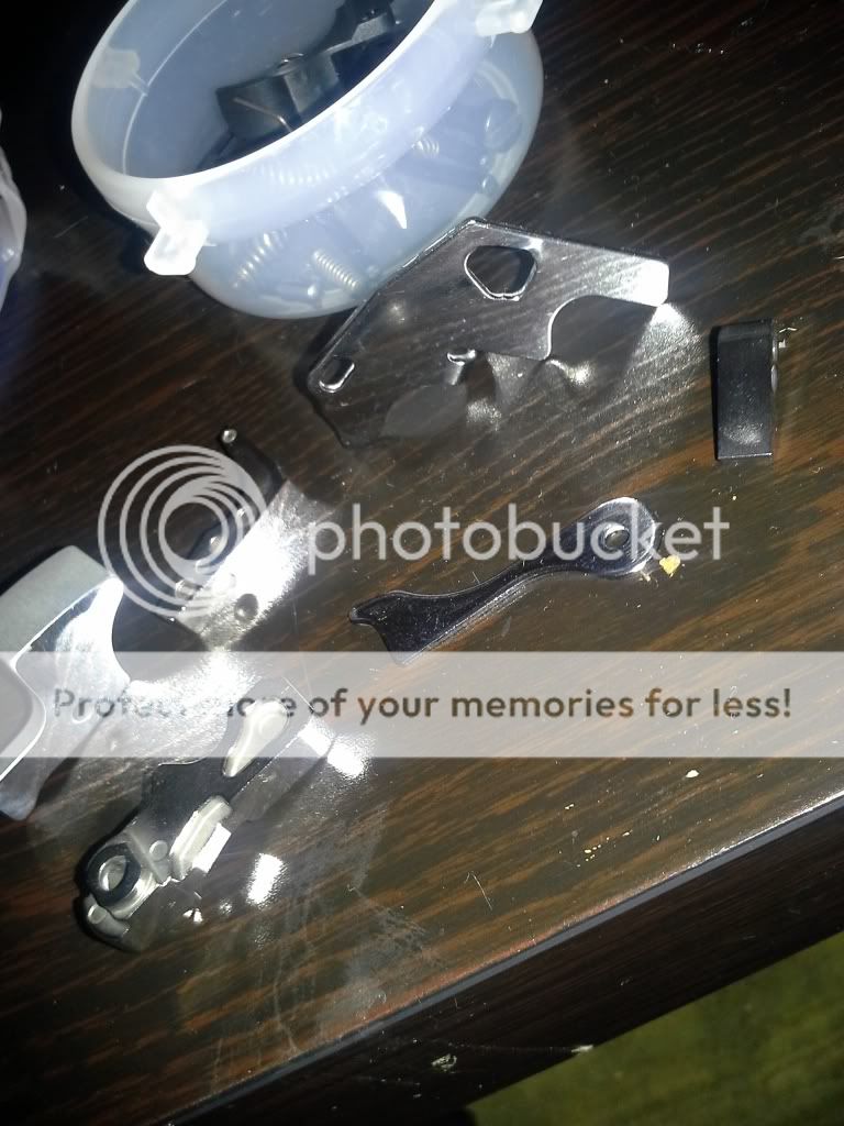

Thanks CGN for recommending Volquartsen extractors..
blsonne
BANNED
BANNED
9   0   0
Toronto
..for my 10/22s! I cannot believe the difference these made. Soooooooooo much more reliable.
Seriously, these should be stock. When you go buy a 10/22 get one of these and swap it out before you do anything. What are they, like $10? You have no reason not to do this :)
Now to re-radius and polish my bolts...
I found re-radiusing the bolt made the biggest difference, extractor helped only a little. Your gun will feed subsonics once you do it.
Trigger job and polishing internals including inside of receiver made the biggest difference for me. I radiused my bolt but just used sand womdering if I should take it down some more.
Polishing my bolt and receiver made a huge difference. Cycles subsonics with no issues. I haven't bothered radiusing the bolt however, just because I've been happy with the performance. Anyone running a VQ extractor with a Bentz chamber? I don't have any extraction issues of spent cases, I'd just like to be able to extract live rounds from the rifling.
What did you re-radius the bolts on, a grinder, belt sander or manually?
I used a diamond sharpening stone from my sharpening kit, normal file and sandpaper seem to do nothing but polish. Took my time and turned out really well.
