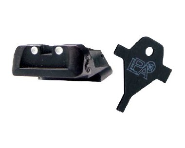

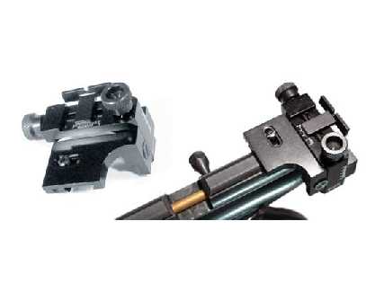

That reminds me, I'm still looking for a rear dovetail sight so I can get rid of the cheap optic.

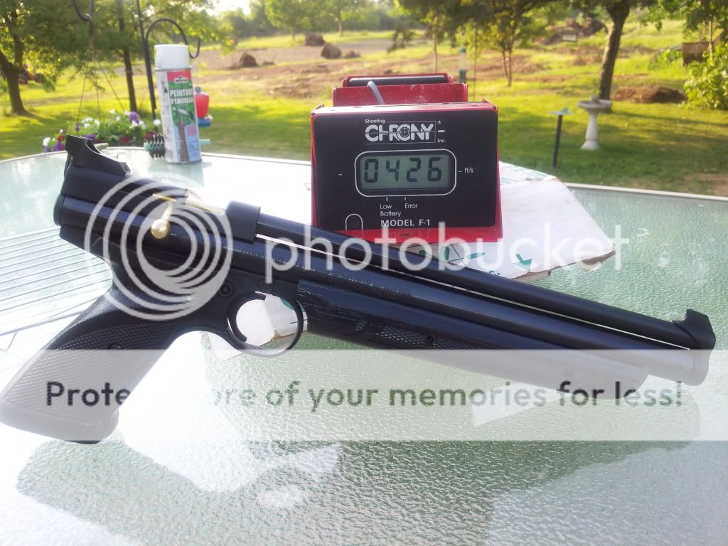

I tested two different guns with Premier hollow points 14.3 grain both with a 10 pump average of 428 fps out of the box.
One got a flat top piston kit from scopes and ammo and now shoots an average of 465fps.
The other has the flat top piston kit and 14" barrel and shoots just under 500fps with 10 pumps.
Yep - works great, 10 pumps Crosman 14.3 grain Premiers:
30 yards rested, the barrel was loose in the forward band so I wired it to the lower tube – group decreased by more than ½.
Did some trigger work and installed a flat top valve kit so now I get the same velocity with 7 pumps as I did with 10.
As for rear sights, there are a couple different types:
Williams ($90)
LPA MIM ($50)
