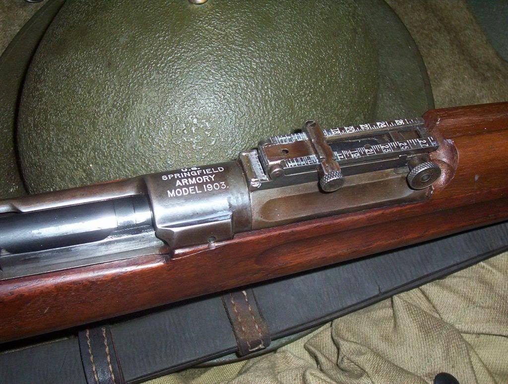

So, here is the back ground on this piece. About 7 years ago I picked up this beautiful 1903 Springfield made at Springfield Armory in mid 1908 that was re-barreled in September of 1918. The stock is in beautiful shape and boy did I ever enjoy shooting it. Then, 4 years ago, I picked up Joe Poyer's book on the 1903 Springfield which is loaded with data (which I will get into a bit later). I did some reading here and there through out the book, covering relatively few of the points in the book, but all in all, just enough to learn that majority of the parts on the rifle are very much original to the 1907-1910 period with a few small parts being correct to 1917-1918.

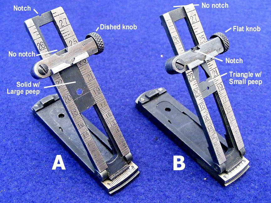

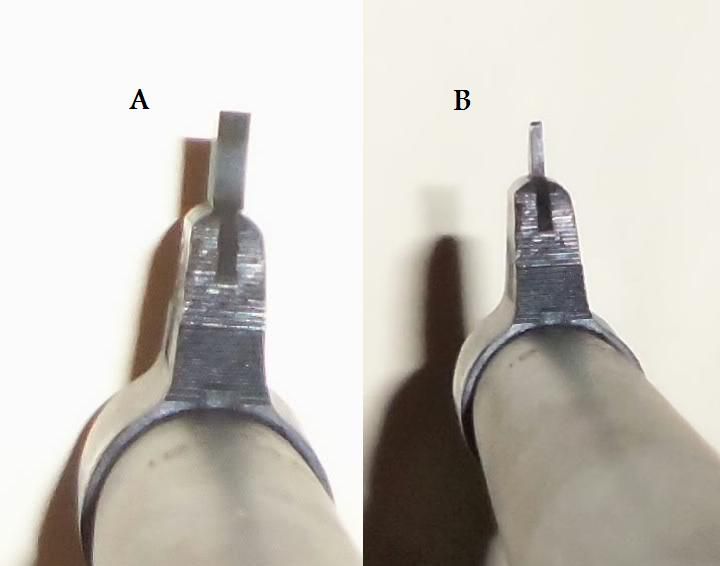

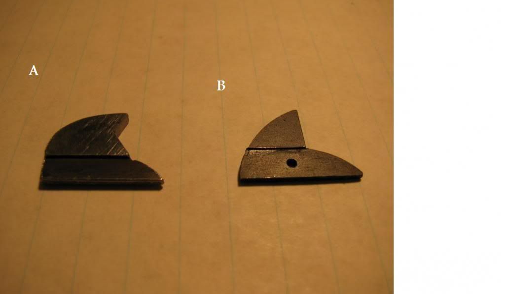

There are two major exceptions (by my count). While little things like the Wnidage Knobe and the Slide Binding Screw (elevation locking screw) are for the most part generally over looked and few pay attention to thing like that I can tell you that both the knob and screw are correct to 1917-1918. Ehhh ok, I would like to have them original.... but ok. Well, in the pictures bellow, there are two different front and rear sights for the Springfield, Rock Island, and Early Remington Produced 1903s. The sights listed as "B" is the standard rear sight found on 99% of 1903's.
Then there is the 1% out there, like mine that have the sights listed as "A". When I first saw pictures of original 1903s with the rear sight that had the little triangle opening and the 1/4 round front sight, and compared it to mine, I felt cheated and I swore I would one day track down the proper front and rear sights and put my 1903 back to original. But, after getting Poyer's book on the Springfield, I found out 2 interesting facts about the front and rear sight on my rifle,

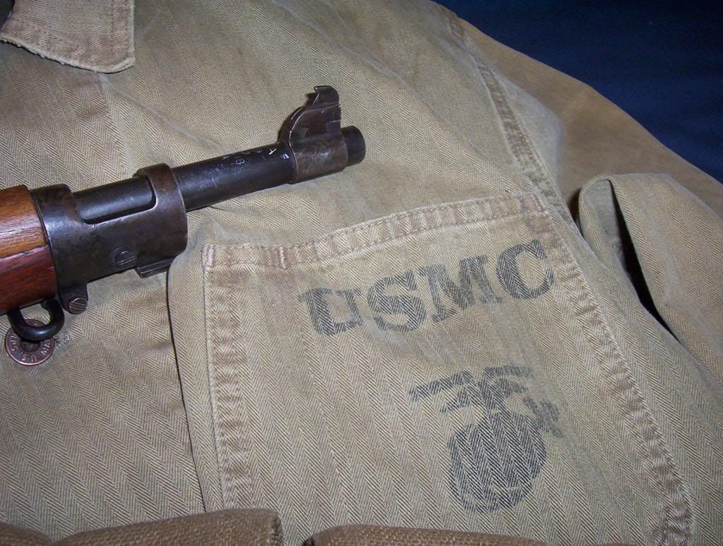

"In1919, the U.S. Marine Corps adopted a new "No. 10" front sight blade, that was twice as wide at 0.10, and the "No. 10" Drift slide with a 0.10 aperture. the combination of the No. 10 front sight and drift slide provided a 250 yard battle sight. These were used primarily om 1903 and 1903A1 rifles rebuilt for use during World War 2"
Well, currently, I am in contact with a few guys down south that are going through the information that they have access to, and it is looking very much like this old rifle might have some real horrors that is saw in not one but possible two world wars.
