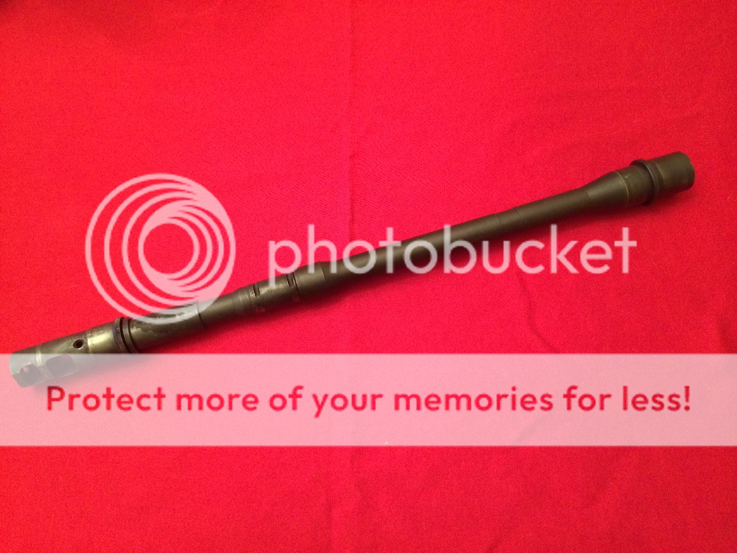

There are 2 things that differentiate AR15 barrels from ACR barrels: The gas port size and the cross pins mounting the Gas Block on the ACR.
I've used 2 ACR barrels on AR builds, all they need is the gas port enlarged.
I think what people want to know is if the gas block cross pins are ready to go on - that the barrel has been machined to accept them (see photo below). If this part isn't done yet, you're looking at a 18.5 AR barrel with a larger gas port.
