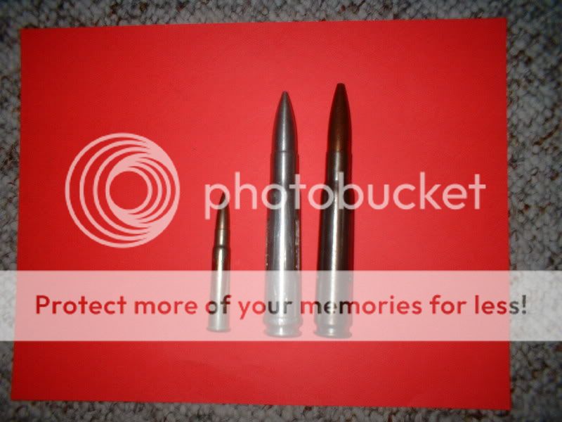

I take it that original .55 Boyes rounds are unobtainable?
The .55 rounds are not "unobtainable", but at the same time, they haven't been made since about 1943, and they keep getting harder to find. I had a Boys rifle in 55, and would buy every round I could find at the gunshows. On average, I seemed to find about 5 rounds a year, at between $15-25 a round. Then, another CGN board member found me a hoard (almost 50 rounds) at only $10 a piece. I was good for a year or two of shooting, but the end always loomed. These days, it is rare to find a round at less than $25, and I am starting to see prices of $40. The sub cal rounds can run from $125 to $300, and the fluted training round can easily fetch $100.
50 Cal BMG is, by comparison, easy and cheap to find. My feet rest on an ammo can of 100 as we speak.

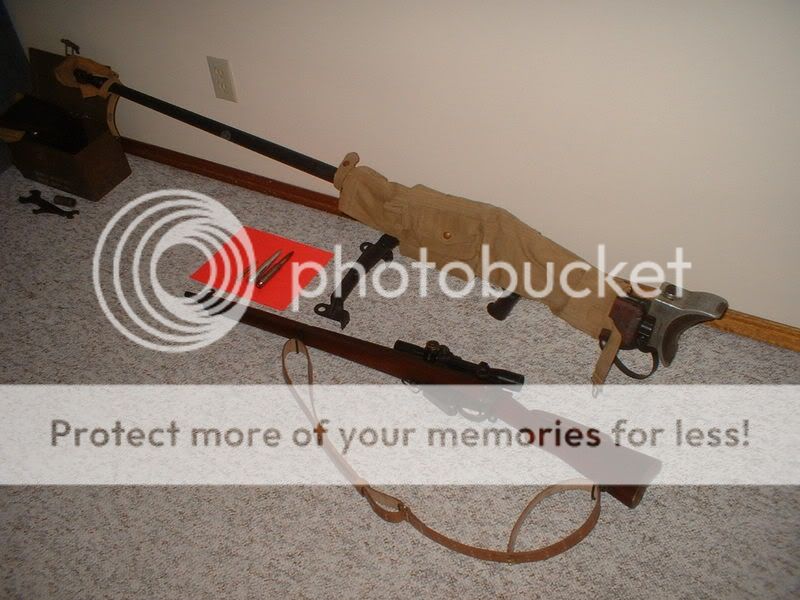

Here were some shots (courtesy of mtallman) from last years Battle of the Bulge match. One is the PTRD (owner missing something), the other Boys rifle (mk2 flashider but a mk1 bipod still init's origional .55 cal, owner DD) and mine with the fencepost barrel.
In the above photo you can see where the other pussys wore mukluks for the shoot. Heck, it was only -30 that morning....what are they going to do when it gets cold? I am the guy with the black boots on.

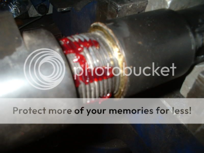

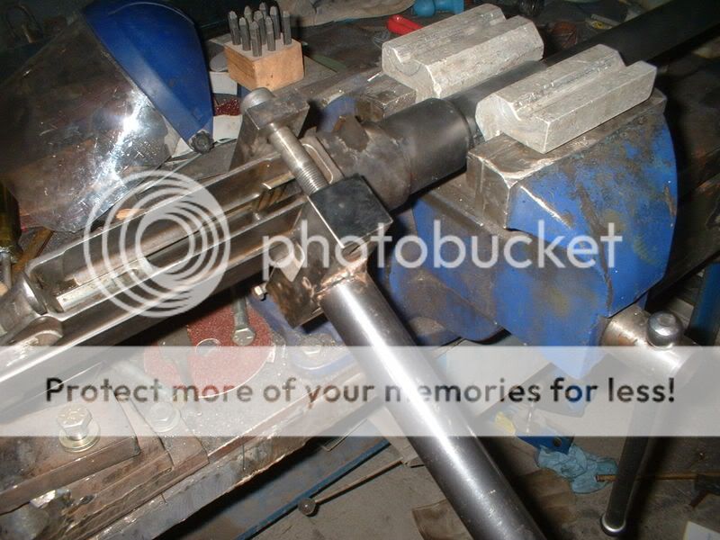

BTW you can remove red loctite by tightening the threads just a little, then undoing the joint. This might be a good method if you don't want to use heat.
Good tip, but normally a barrel will already be on so tight that turning even a little tighter will be near impossible. When I say heat, I am not talking about red hot...just warming up the metal to where you don't really want to hold onto the metal for too long, but not hot enough to boil water.
