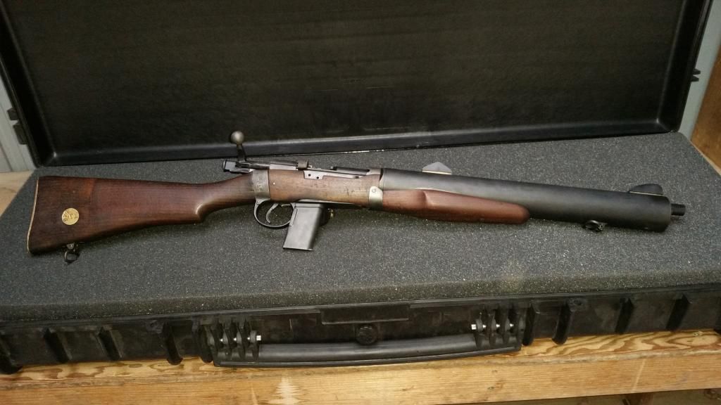

The De Lisle Carbine was originally tested in May 1943 by the British Combined Operations for commando raids on the French Coast.
An initial 17 guns were built by Ford Dagenham and a further 130 guns were built by the Sterling Factory.
Serial #1015 was a combination of two guns Ser#1002 and # 1015. They were returned to Mr. De Lisle after the first round of endurance testing. Both guns were damaged (after 5000 rnds were fired per gun) so Mr. De Lisle rebuilt them into one gun. It is marked as THE DE LISLE COMMANDO CARBINE MARK II.
This is an exact copy of the De Lisle Carbine Serial #1015. The only difference is the dummy suppressor with no noise reduction to the 45 acp round.

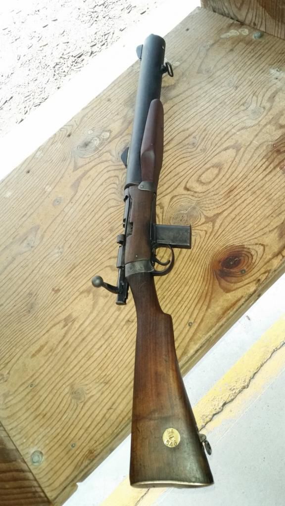

I had a fantastic day at the range trying out an exact copy of the De Lisle Carbine. My initial impressions were how well everything worked very smooth, excellent fit and finish. It was apparent allot of hours went into this project very high quality workmanship on the silver soldering and welds. Shooting it was equally as nice the magazine fit smooth and snug. I had fun testing it at 25 yards put a good 25 rounds through it good times! It definitely attracts some attention its not something you see every day.
Thought some of my fellow CGNers might like some pics and a short video. I will post some more pics and vids of future outings and tests should have some more shortly.
How long did that project take?
It took about 1.5 years of research including tracking down the armourers drawings then another 400+ hours of actual hands on work fabricating, hand fitting, testing, adjusting ect. Lots of obstacles to encounter along the way!
