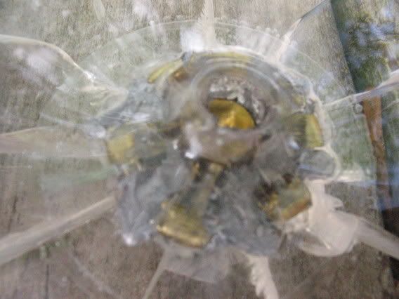

well here is a 124g JHP montanna gold at 25 meters vrs 1 inch thick bullet resistance glass
fired out of a glock 17 did NOT go through went about 1/4 - 1/2 way through
very neat to see the bullet opened right up inside the glass!
