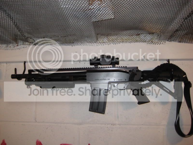

Heres a pic of mine with some Magpul, Fab defense and S&J hardware add ons... It's not the greatest pic, I really should sit down and do a photoshoot.
I love that stock, I wish CanAm still had a few in stock. One queation I have is on the red dot holographic sight. What brand is that, is it a cheaper one, and does it lose its zero after a lot of firing? I've hear most cheaper red dot's cant handle the recoil of a shotgun, but I have never met anyone who has ever tryed it. Ive been hoping it isnt true, because I can afford a more expencive one, not that the sights wont do the trick for me. I'm just curious.
