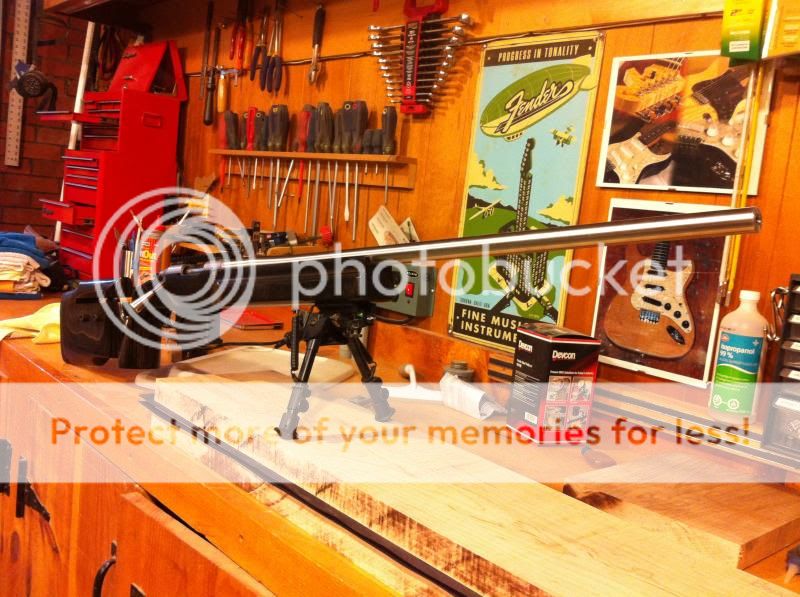

maynard was very kind to give me a maclennen 1-8 twist heavy palma barrel which i have to replace for him soon, i had grizzly gunworks chamber it in .223 wylde for shooting longer throated bullets. finished at 28". its sitting in my home made stock, and as you can see, its standing on its soon to be replacement.

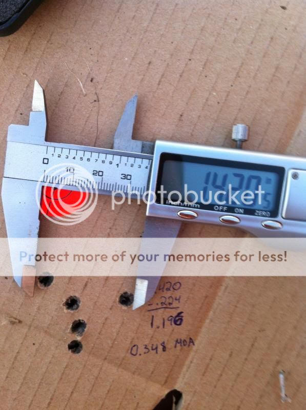

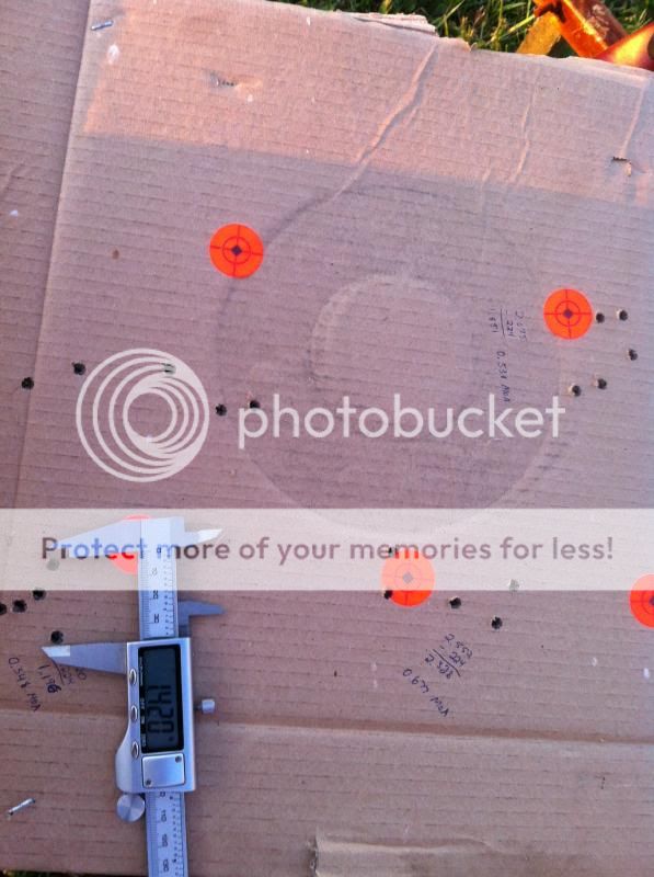

so here are some 300m groups i shot earlier today, under pretty perfect conditions. the first group i have no idea what happened, but i changed my shooting position to a more comfortable position (i was laying on a prickler), i was adjusting my POI between groups as well.
group 2 and 4, if i did my math correct were 0.531 and 0.677 moa, and group 3 was something special.
so needless to say, i'm pretty happy with the results thus far.

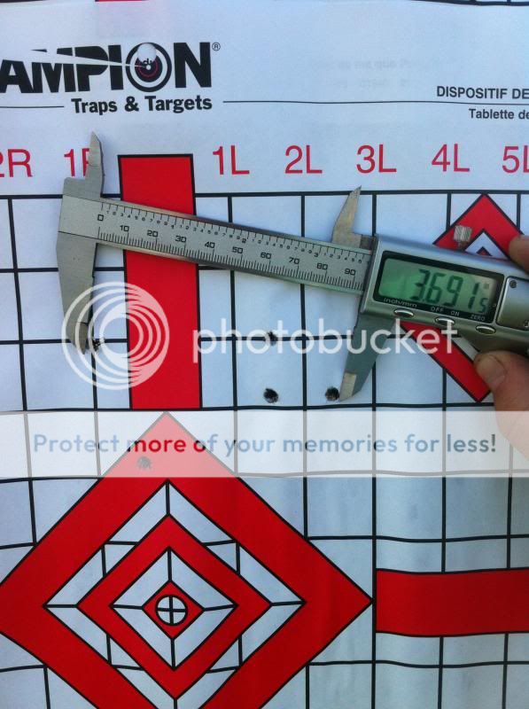

also this is the first 5 shots i have ever taken at 500m. i was hoping to get my 600m come up but we were interrupted by the police again so we decided it was best to shut down for a while.
a little better picture of the replacement
