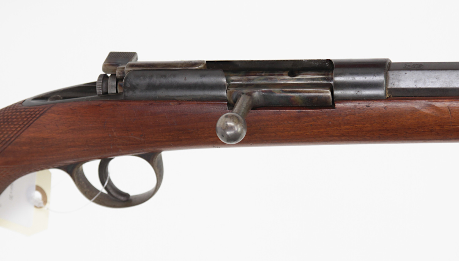

For reference - the Model 35 in 30-30:

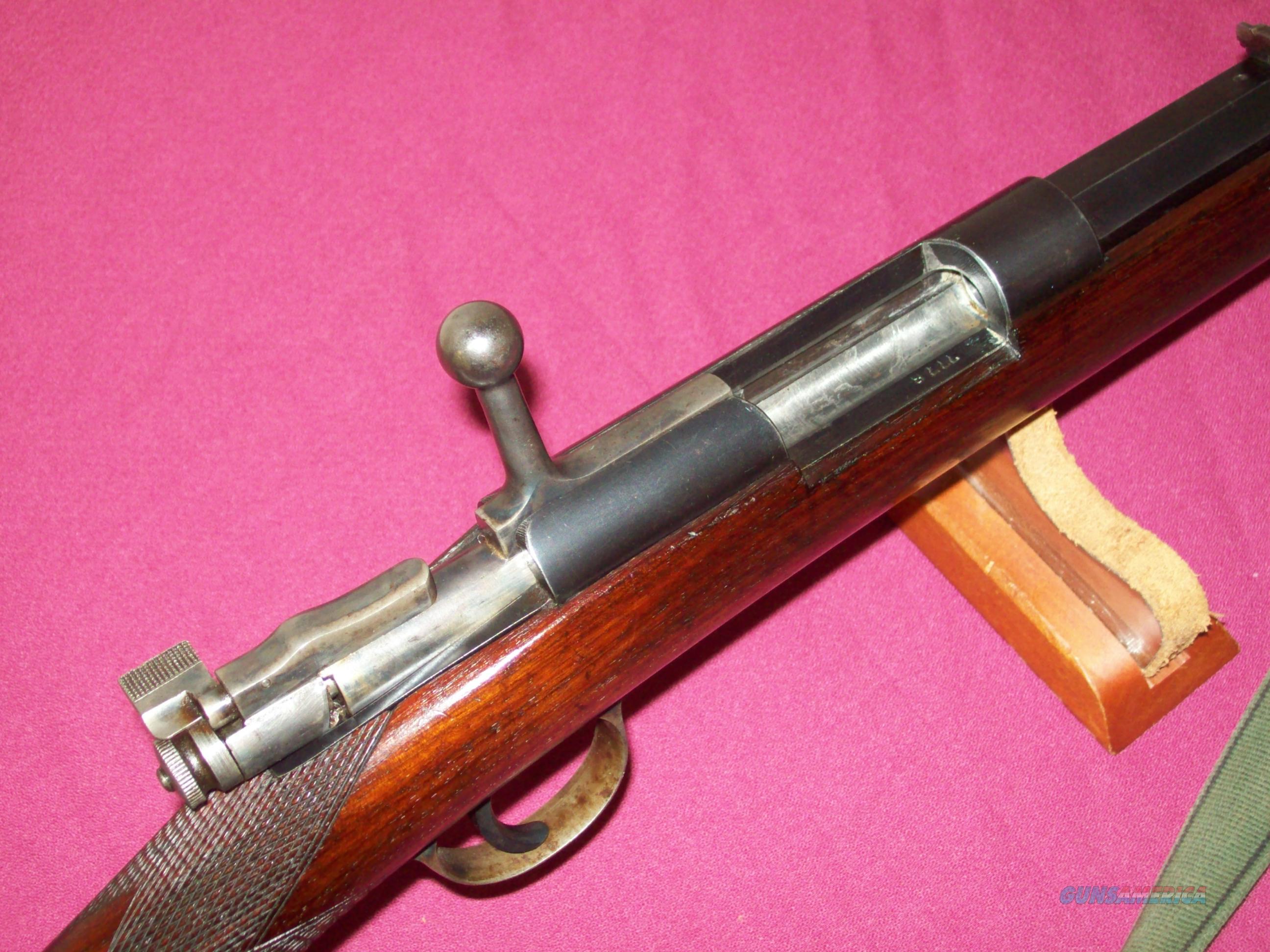

...a Model 25 in 32-20:

Can you see a difference? I can't. Not seeing any evident "beefing up" of any surfaces or sturdier looking structures. I'm guessing they're identical, but this isn't a realm of human endeavour that richly rewards guessing...
