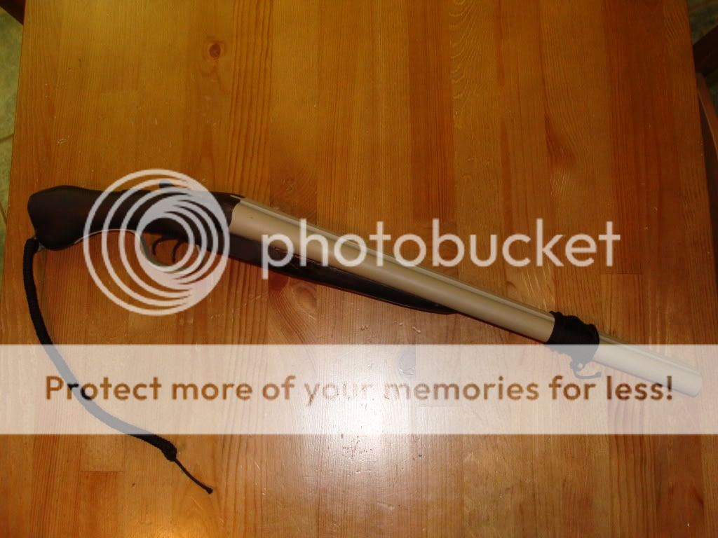

So to make things short, I bought a cheap SXS Shottie from Tradex last year and sawed off the barrel down to 18.5in and used it as my truck gun.
A few days ago I thought I'd let out the Bubba in me and this is what I did: I decided to cut down the stock and make a "Pistol grip" and I ended up with a final lenght of 26 3/4in, I screwed the old sling swivel in the pistol grip and I attached a "rat tail" made with black Para Cord, I added more Para Cord on the Barrel and I finished it with a two tone paint job.
Not too bad for a 90$ Shotgun! It'll follow me pretty much everywhere I go from now on
Beware Zombies and Squirrels

Barrel length must be 18in since its a break action and the overall length must be 26in...
My barrel is 18.5in to be on the safe side and the overall length is 26 3/4in

Yup. You are safe.
Cool job by the way, fun little truck gun. Just watch the webbing between your thumb and trigger finger do not get hit during recoil by the unlocking lever.
haha yeah that hurts a little.. but the bleeding is annoying. It lasts longer than the hurting part. A 16 gauge bit me like that last summer, slugs though. :)

The one posted in this tread has a thin fore end which doesn't help because the front hand will need to absorb a lot of recoil...a strap of some sort up front might help, but a longer and thicker fore end stock would be better.
When I shoot a PGO shotgun I push forward with the front hand and pull back with the rear to create some tension and then absorb the recoil with both arms.
If I was shooting a PGO with a tang action release I would keep my thumb on the same side as my trigger finger ... I usually do this anyways with most of my guns as I find it comfortable and it keeps my thumb away from my long nose!:D
I like what you did with it, you should consider putting a strap on the fore-stock á la the MAC-10/11. Could probably help with the felt recoil on your shooting hand.
IMHO you should have stopped there.
i actually think that old worn bluing and beaten up guns look nice, also more functional with a full stock.
should've could've would've... like I said I was trying out stuff and I think the most important thing is what I think and I think it's pretty neat... It was just too big for what I intended to do with it, it's basically going to be a little shottie that's going to follow me everywhere I might need it... I'd rather carry my glock around but the gods over in Ottawa think differently....
