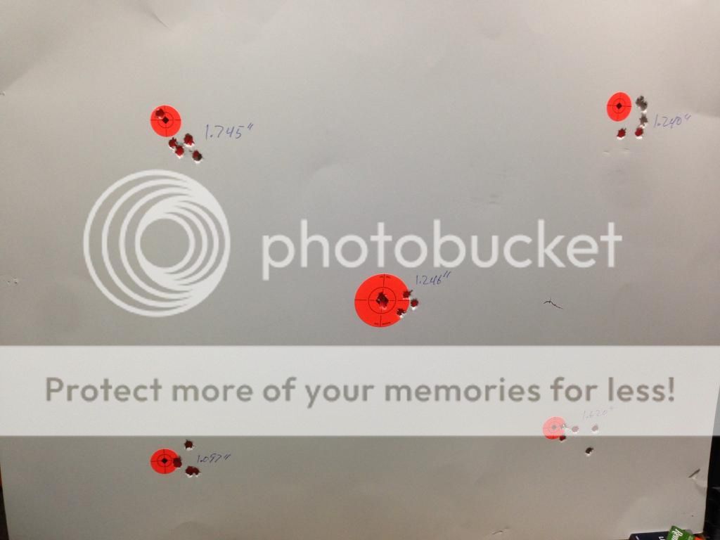

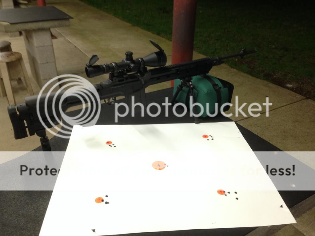

I shot this last Tuesday at 100yds in 35 degree weather and 20-30MPH gusting winds. Speer 125's. No vertical stringing, aluminum CASM mount, night time, Leupold MK4, 4.5-14x50mm, 30mm tube, Leupold MK4 steel rings. Unfortunately, the 600yd shoot was cancelled due to the high winds we had that night and a cold wind chill so 100 was all I could do.
