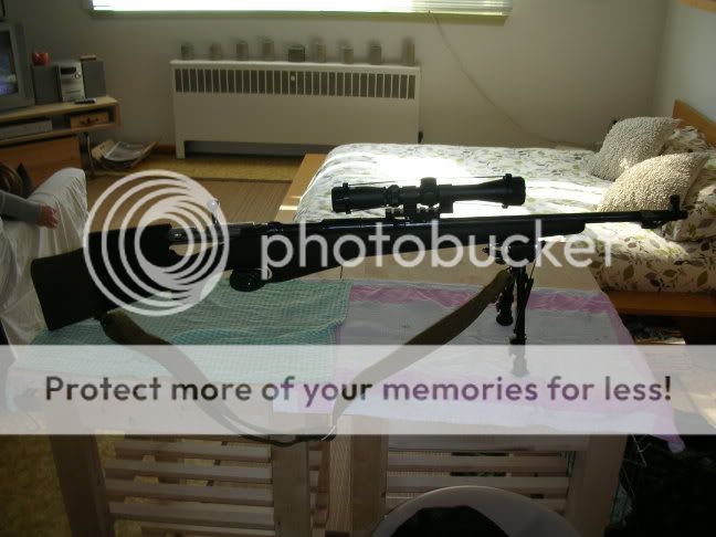

:p to all you purists out there my M44 project is coming along well. I'm really happy with it so far.
What I've done so far:
-ATI stock I really like it. Some have slagged it but I'm impressed so far. I'll likely bed the action once I'm done everything else.
-Darrell Harrison Scope mount. I have nothing but good things to say here the piece is much better then the Bsquare one that I originally baught. The EER scope setup is about the best there is for me as I'm a southpaw so I can work the action with the left hand easily. This is also why I'm not gonna mess with bending the bolt.
-Bsquare rings. They aren't the best, I was looking at the mellet rings but I can't rationalize spending more on the rings then the scope is worth.
-NCstar EER 2-7x32 scope. This was a mistake. I think I'm gonna keep my eye open for a better scope. I know I want something that has more then 6x magnification and the Leos I seen are just to small for what I want.
-Custom fiberglass cheek riser. Awesome cheek weld now.
-Modified Dog leash sling. I just put some standard 1.25" swivels on there and its good to go.
-Cheep slip on reciol pad. I don't know what I'm gonna do about that maybe just leave it the way it is for now. I need the extra 1" cause I'm kinda lanky and I tend to envelop a rifle.
Don't worry the flame suit is on :D . Anyone have any suggestions for a good EER scope?
Nothing perminent has been done to the action yet but it will be ruined when I install the muzzle brake, at that point I will likely grind off the bayo lug too. I know its a bit brutal to be hacking one of these up but I wasn't really into collecing before I picked this one up and maybe I'll pick up a good polish to collect.

I would opt for a fixed power scope, in the 4X range(or skip that all together, and go back to irons). For what I think your going to be doing with it(not hunting small varmin at long range) you realy should not need more than 4X.
Good luck getting the bedding to stick to the stock. Have you shot it yet with the bipod on it?
I will say you will end up not liking how the end product preforms, so don't do anything permanent untill you actualy test the thing out.

I'm gonna keep the EER setup I like the Kalinka mount but I like to be able to work the action with my left hand in the prone so the Darrells mount works out well. I'm really just looking for a better scope. I'd go the lower power fixed route but I'm planning to use this rifle for the range, deer and moose too so I want the adjustable option. The NCstar is ok but I wouldn't recomend it.
LOL, the bayo is gone and for sale with the rest of the stock and other parts.
Now that I replaced the junk NC star rings (which broke while settingthe scope in place) I should be able to sight it in and see just how it shoots in the next couple weeks.
I've put about 40+ rounds through it in this configuration and I LOVE it. Can't comment on groupings yet but it feels really good, yea this stock sucks up a lot of recoil. Shooting in the prone used to actually hurt after about 5-10 rounds, now its much better. I imagine with the brake it will be a pure joy (actually its already my favorite). I developed a bit of a flinch with the old stock cause the recoil was pretty harsh.

I still maintain that proper bedding and recoil pad make way more difference in felt recoil than a brake.

My opinion, if your going the bubba route go all the way, remove the bayonet and lug, and make a nice job of it, polish and reblue the metal.
I don't like the look of the bent down bolt handles on the nagants, so I'm not sure what I'de do there, perhaps just a little 30deg bend might look better.
