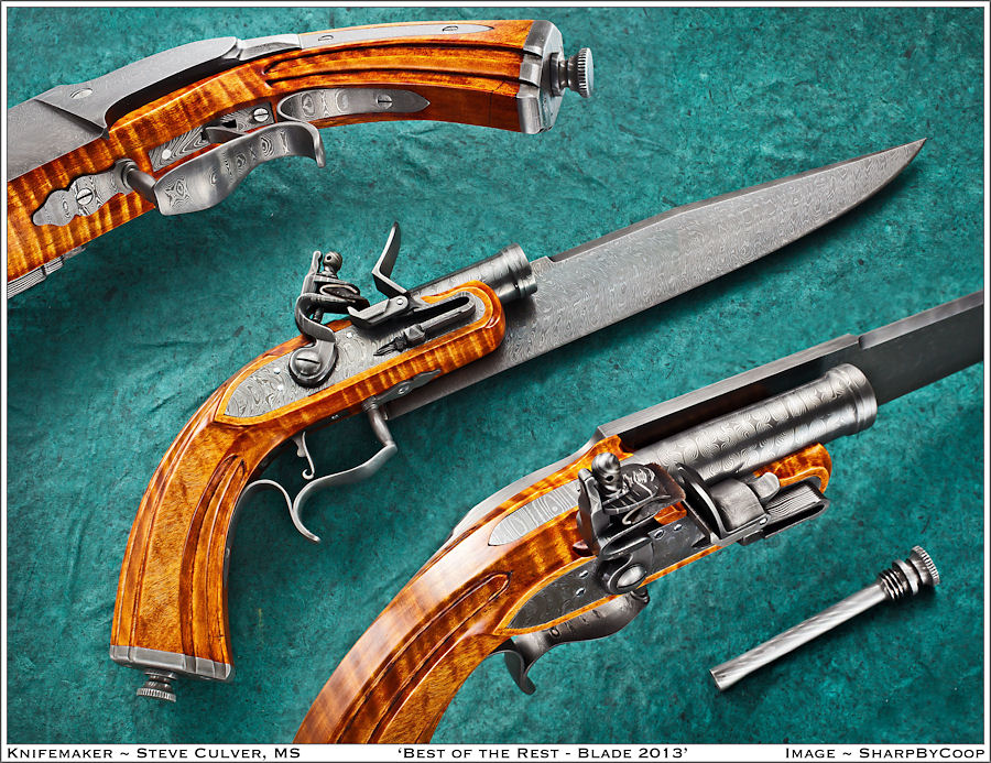

Yes, this fellow is a member on doublegunshop forum and has discussed this on that forum. I believe he has made a damascus double barrel pistol of some sort for some type of "master contest". I believe he makes damascus knives etc. if I remember correctly.

Steve Culver is an Master Smith (MS) in the American Bladesmith Society (ABS). He has been making Damascus knives for a long time. The stuff these MS's guys can do is amazing both artistically and technically. Steve made that barrel for a Cut & Shoot (Handgun knife combination). The lock was his own design and built from damascus as well. He did a WIP is on the ABS website.
h ttp://www.culverart.com/index.htm
