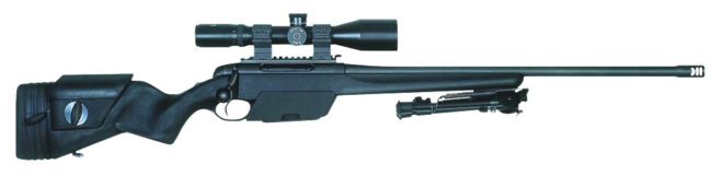

A trip to a gunstore for a quick look around, and the next thing I knew I had ordered a Steyr SSG 04. It started out when I asked if they could order in an 08, and was told yes, for about 3K$. Considering they are about an 8K$ rifle I said I would take one, only to be told that it wasn’t an 08 with the trick folding stock etc, but a more traditional 04. I decided I needed another 300 Win Mag, and placed the order anyway.
A few months later the 04 arrived.
It shipped with a cheesy, but effective hard case, a Harris Bipod, a 20MOA rail, and that’s it. Missing I felt were the mirage band, which is another 80$ but should be in there for free, and a sling. Steyr sends you neither of these.
Likewise the rifle ships with only one 8 shot mag, a spare mag cost a mind-numbing 175$. The 23.5 inch barrel sports a fairly nice and effective break.
All in all the rifle with taxes in runs a little over 3K$ (I would recommend that if interested in any Steyr rifle, you might want to contact a dealer/importer, as even with importation fees you would likely save a bundle. SSG04s can be had in the US new, for as little as 1800$, that’s half of what some Canadian dealers want).
To stick with the Euro Classic theme, I opted for a Schmidt and Bender PMII 10X42 scope, one of the most classic pieces of ‘tactical’glass, and a Spuhr uni-mount to put it in.
The glass was a no brainer, the mount took a while to arrive at. I had wanted a one piece for certain, but finding a nice one, that was solid and quality was difficult, and the choices were few, though interesting. Eventually the Spuhrs dedication to Schmidt and Bender led me to choose that. With the original 04 coming with a 20 MOA mount, I opted for the 0MOA Spuhr mount,

The reality is that the prices on these rifles drives them right into Sako TRG42 price ranges, particularly here in Canada, and especially so of the 04A1. Being slowly nickled and dimed in putting this rifle together made the costs tolerable in doing it, but when sitting back looking at the costs it makes me realise I should have just bought the Sauer 202 Wolverine I really wanted. There is little to fault with the 04, it feeds and shoots smoothly and beautifully, is easy to maintain and setup, but it lacks some basics a rifle in this class should have, like a UIT rail, which other members of the Steyr tactical line sport, but which this rifle doesn’t. In the US and Europe this likely helped keep the price down, being a plain jane marksman’s rifle, earning it that SSG designation. But something as simple as the lack of a UIT rail to limits some of the useability of this rifle.
The stock is a standard SBS family stock, hence the less than ideal forend. The butt accepts a side insert to which the adjustable cheek piece attaches. To remove that totally you unscrew the upper half of the cheel piece and pop off two locking tabs. Then the cheek piece is out of the way, taking with it the spring, as the cheek piece is spring loaded (you can see what looks like a magazine spring under it, which if you dont like you can remove. Once the upper part is gone you can remove the bottom half and have no cheek piece on the rifle. Removing it takes about two minutes. On rifles like the Elite you can replace the insert to which it attaches with a cartridge holder (4 rds IIRC) for the 308 family.
The buttpad is adjusted to the full range in these pics. Like the cheek piece loosen the tightening nut, move it to where you want and retighten. You can also add or remove spacers to get the length you want
