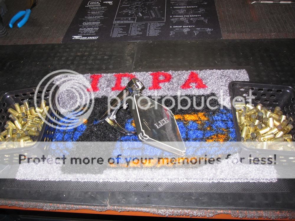

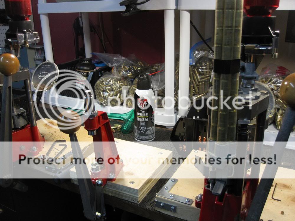

I decided to get a cheap Lee single stage just for removing primers, a universal decapping die and the Lee AutoPrimeXR. I stuck the "decapping station" in between my presses.
I tried it out for the first time decapping and priming 200 casings with Federal primers. What a pleasure. The learning curve on the hand primer is much, much shorter than the Lee 1000. :p The Lee 1000 on the other hand can make you loose a few hairs on your scalp before you learn to run it smoothly.
I am just going to pop the decapping pin up on the Lee 1000 and run the primed cases through all three dies.
