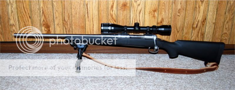

Back the beginning of the month I picked up a brand new varmint rifle for this year. It was a Savage 16FLHSS in .22-250. thats the Synthetic stock, left handed, hinged floor plate mag. with the Stainless steel sporter barrel. I topped it off with a 4-12x40AO BassPro/Redhead Pursuit brand scope and Millets steel rings. This is the fifth Savage rifle for either me or my boys but is the first center fire. All the others are .22lr's, .17HMRs or combo guns (.22lr/.410). I've waited a bit before posting about to give me some time to break the barrel in and work up some loads. I've got it going pretty good now so I figured I'd give a bit or a report on it with the time to be pounding on the Coyotes right around the corner.

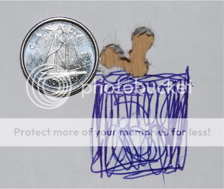

I was pretty happy with that and wasn't expecting much more out a 22" sporter barrel gun. I loaded up with the last loads I had at 36.2grns just under max. I fired the first two shots and could believe my eyes.....one hole. I fired the third and it dumped right in there leaving a nice clover leaf in the paper. I waited for the barrel to cool then loaded up with my last 3 shells in the same charge.......same results. When I retrieved the targets I measured them up at .365" for the first group and a .291" center to center for 3 shots at 100yrds.
I'm one happy camper. I went back out yesterday with a slight breeze and shot a couple more groups to dial the scope right in and make sure I didn't just have a fluke day. Same results 5 shots at 100yrds..... .379"!!! I am completely amazed with the gun right now. It's out shot any rifle I've ever owned. The only gun I've come across that shoots close is by buddies heavy barreled Savage in .204 Ruger. That gun is just amazing with his hand loads. I've seen him shoot some groups in the low .200"s and high .010"s with it on a calm day. If any one has been looking at a Savage rifle I'll be giving them 2 thumbs up right now. I've had the chance to do much hunting with it yet but I've manged to bust a couple crows out over 200yrds and missed a couple Jacks through no fault of the gun but I've got some time off over the holidays and thats going to change. Here's a pic of the gun and the .291" group
