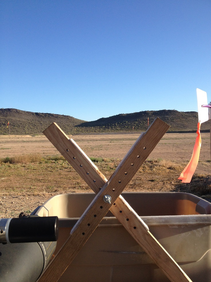

The rifles are supported by crossed sticks in the front, but must be supported by the shooters hand in the rear. No sand bags or grounding of the rear hand or rifle, so keeping steady is a skill for sure.

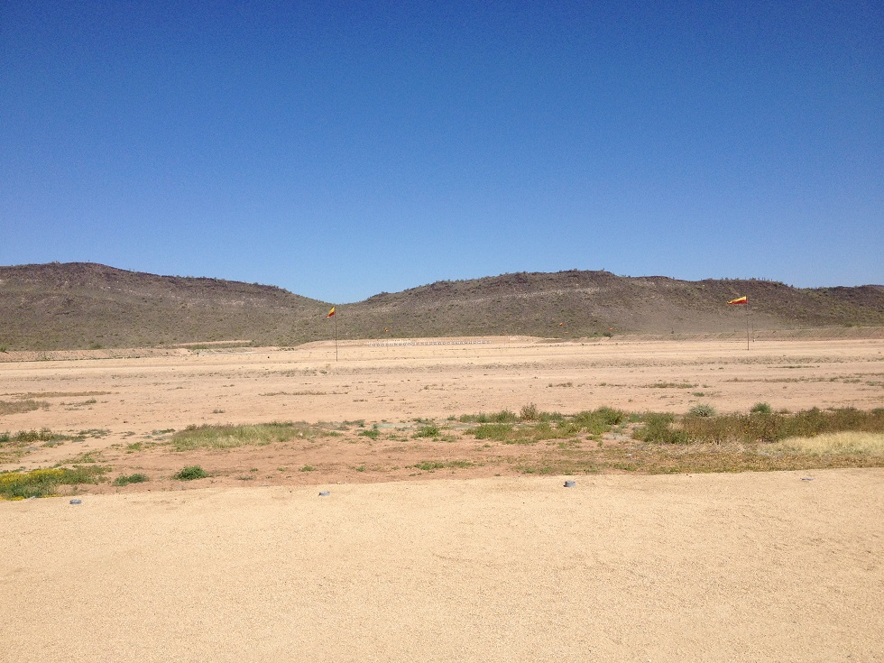

I recently shot at the 1000 yard World Championships at Ben Avery in Phoenix Arizona. A special match with 4 days of shooting where all targets are at 1000 yards. It sure was more fun than practicing in the rain here in BC :)

At the moment I can shoot steel to 800m in Heffley Creek, but they don't have a full set of wind flags and these things are so sensitive to wind that you really want all of the flags.
