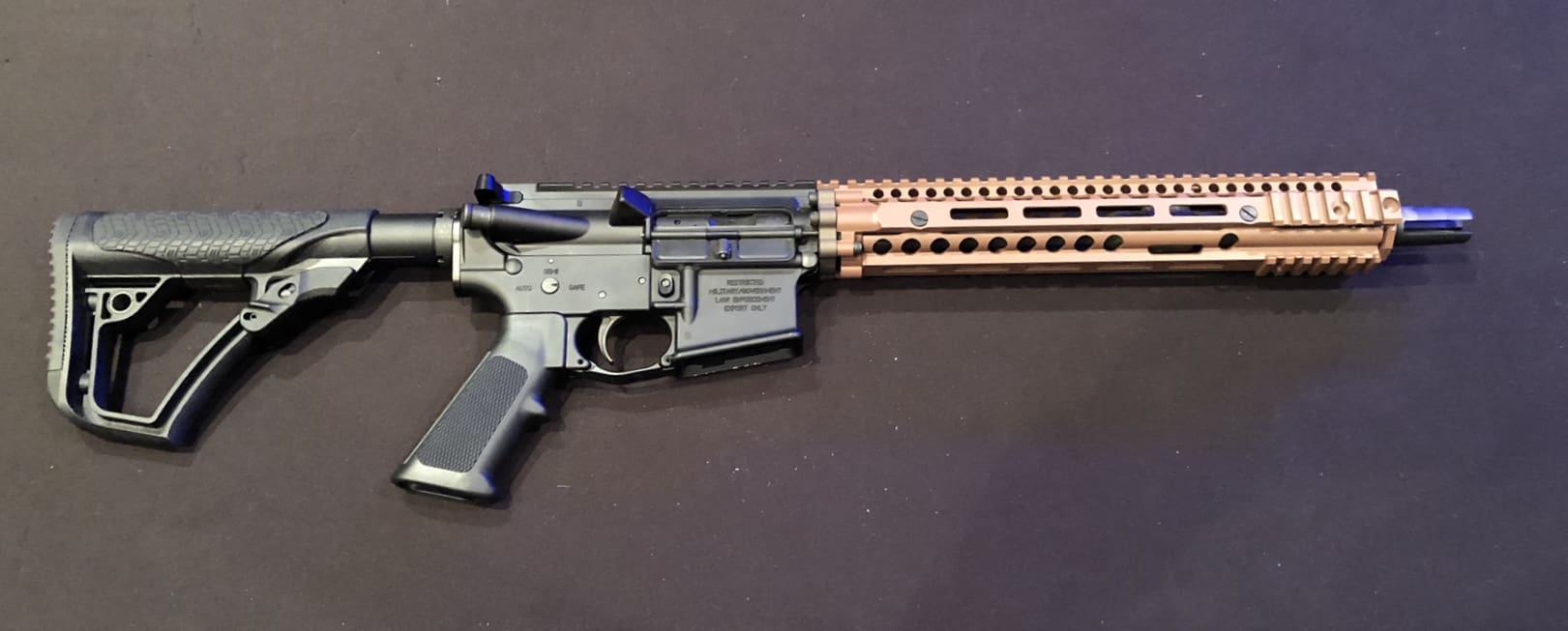

So I think I found the rail I would like... but its only a Daniel defence prototype.
So I am left searching for something similar, a rail that IMO is the best of both world: free floating, weigh conscious, SOLID, a good capacity for mounting crap with front quad rails and the rest is m lok and confortable to hold.

Browells is listing it as discontinued. And yes its a game of compromise. To me the Daniel defence rail would be ideal but they dont make that one I posted. What am I mounting? Right now not much but I would like sturdiness, I am fairly sure I could drop my DDM4V5 from way higher then 5 feet without any rail deflection.

What about getting the excess pic rail sections on your current rail? Looks like that's exactly what DD did with the prototype. Folks have had success doing similar on the huge ass pic rail system on the Rob Arms XCR. Souldn't be cheap, and you'll need to coat or paint it after. Would be one of a kind though.
I don't think the dd rail will ever drop.
Btw on the strength of the dd quad rail check this video at 15m30 and 29m15. Tell me what yoy think vs the 5 foot mk13 drop :p
