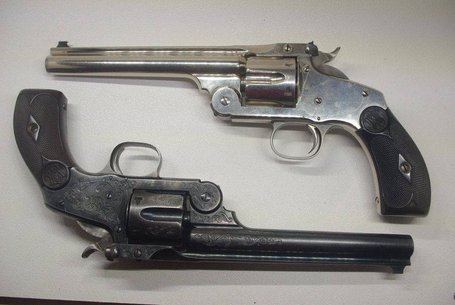

Two early specimens of the .32-44 Target Model. The top one has a rare fixed rear sight which was only applied to this model from 1887 to 1889.

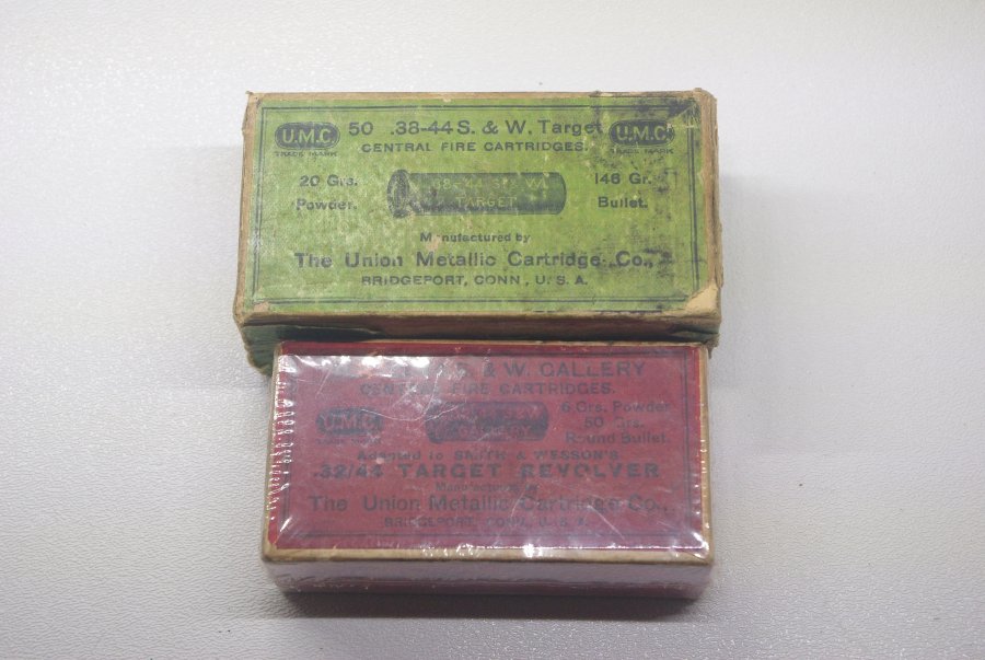

Original .32-44 and .38-44 target ammunition
