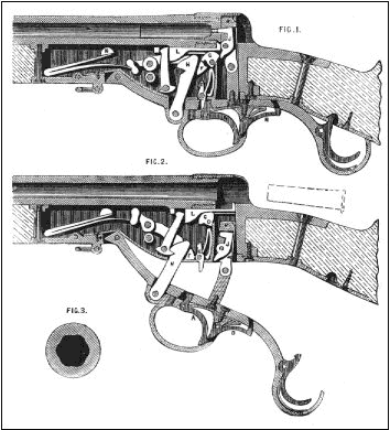

The rifle invented by Mr. W. Soper, of Reading, and illustrated in Figs. 1 and 2, was one of the number sent for the recent competition at Woolwich, and was rejected on the ground of "complication of breech arrangement." In this rifle the breech-piece is formed of a block of steel R, working freely up and down in a vertical slot at the rear of the barrel, and secured to a lever fixed at the bottom of the lock, which is placed in the center of the stock. The striker J is mounted inside the breech-piece, and works easily without any spring. The #### is also secured to the breech lever in such a manner that the breech-piece and #### are worked simultaneously. The Soper rifle
The attachment is effected by the swivel H, furnished with a projection and recess for working the extractor L, so that the one movement of drawing down the lever opens the breech, cocks the piece, and throws out the cartridge case. The trigger A is mounted on the lever, and has no connection with the sear E until the breech is placed home, and thus the rifle cannot be fired until the safety catch B is pressed. For cleaning purposes the lock and breech-piece can be removed by withdrawing a couple of screws. Fig. 3 shows a section of the rifling, the calibre being that of the service rifle.
The trials of this rifle at Woolwich were satisfactory. For rapidity twelve rounds were fired in thirty-nine seconds with three mis-fires; the mean deviation of eight shots fired for accuracy from a shoulder rest at 500 yards, with Boxer cartridges, No. 3 pattern, was 2.30ft. Many excellent results have also since been obtained. Nevertheless we cannot but agree with the committee that the mechanism of the breech and lock is too complicated for a purely military weapon, and, moreover, that they were perfectly correct in doubting the value of the safety catch as a substitute of the ordinary half-####. Mr. Soper has expended a great deal of ingenuity, and has produced a weapon which gives good results, but we think it cannot be denied that it is unsuitable for the use of the soldier.

Wow, can't argue with the accuracy, but a military rifle should have more in common with a shovel than a fine timepiece. Cool bit of history, for sure.
Marvellous rifle Janice, and I'd give my eye teeth for one in military furnishings.
There are lyrics to a contemporary song bemoaning the fact that the military didn't go the way of the Soper due to the fact that it was already committed to the Martini Henry! It would seem the "trials" were merely an exercise in futility for Soper and his rifle, although I don't think it can be argued that this mechanism though brilliant is poorly suited for military applications.
I also found it very odd that Soper's business partner Sgt...? who was operating the rifle during the "trials" did so laying on his back with the muzzle in between his feet! Much like a "cross sticks" type method. The only thing that I've been able to come up with is that the Trials rifle that was tested, was the under lever type you provided in the first pick (he later went to the side lever). Like a lever action, it would be tough to operate from prone...not as tough life would be if one were to accidentally shoot a foot off though!?

Actually, the action on the side lever sounds more like the pinch of the right thumb and index or middle finger on the same hand? Far cry from a two man operation. Its most likely an improvement to the under lever. From the looks of the under lever it may have provided the operator a better fulcrum to eject the spent case, but there are a lot of linkages that can bend or wear. These workings are also exposed momentarily when cycling the rifle {read dirt and sh1t in the works:p}. The side lever Soper seems to have taken some criticisms to heart and probably resulted in a better all around design from the users vantage point. As has been stated, they were a popular rifle at one point of time...bad designs that are a two man operation to load and fire are never popular.
