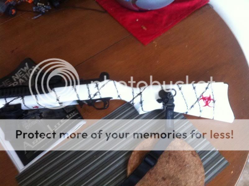

Hi Folks,

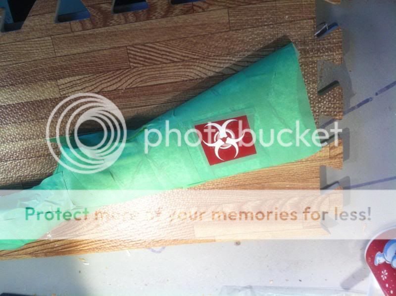

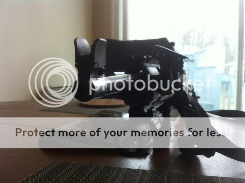

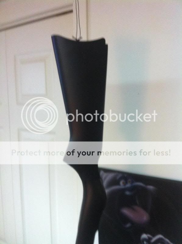

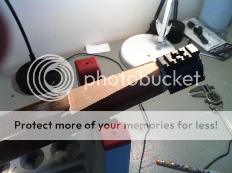

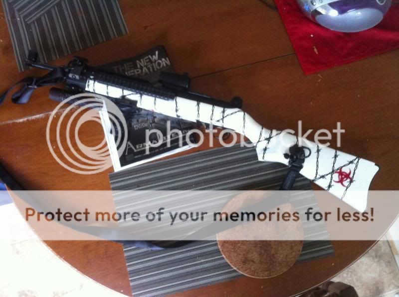

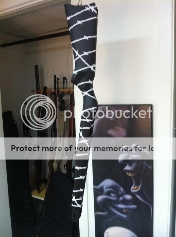

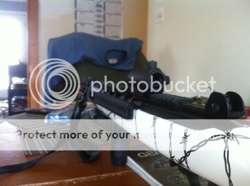

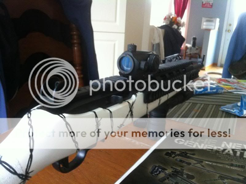

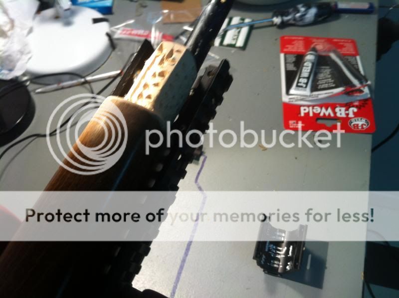

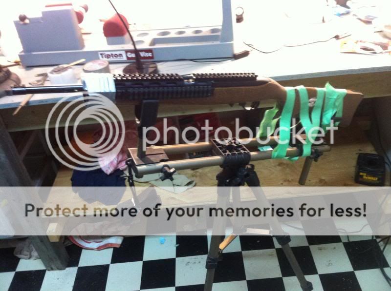

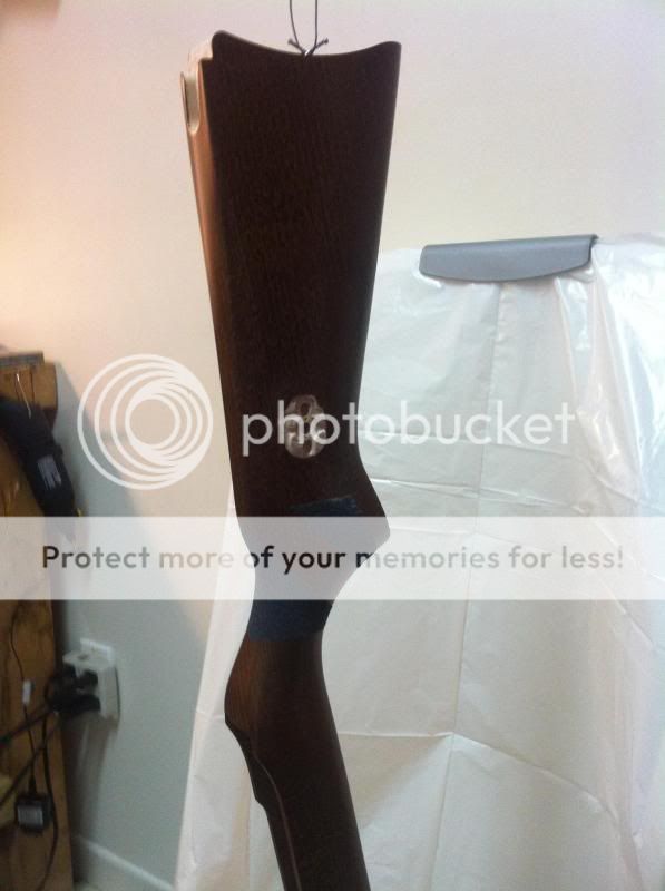

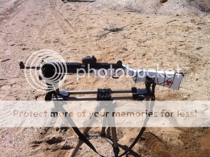

My first post as a project. I just want to share with you and know what do you think about this one.

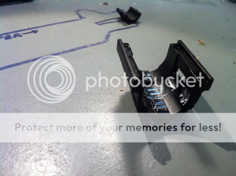

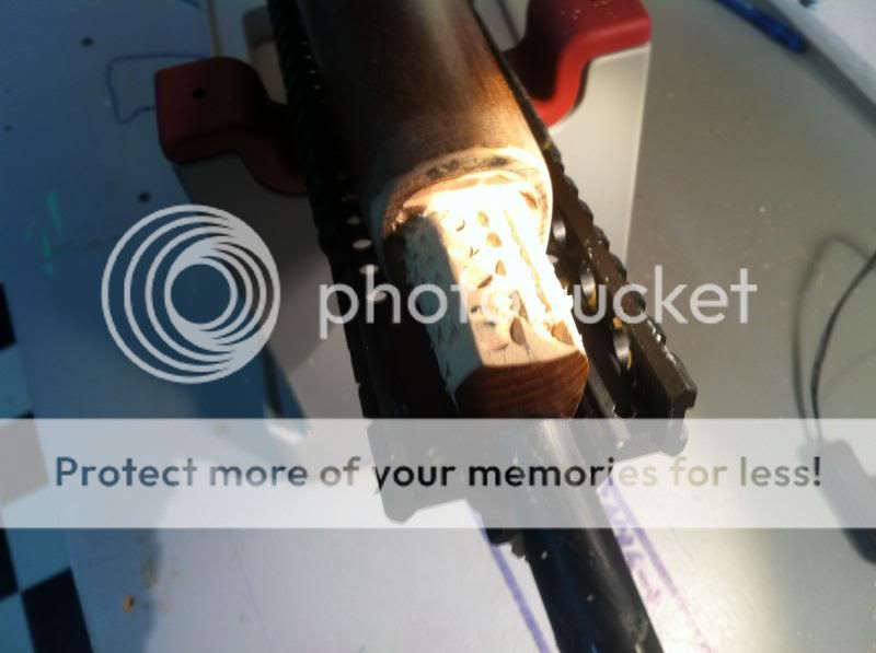

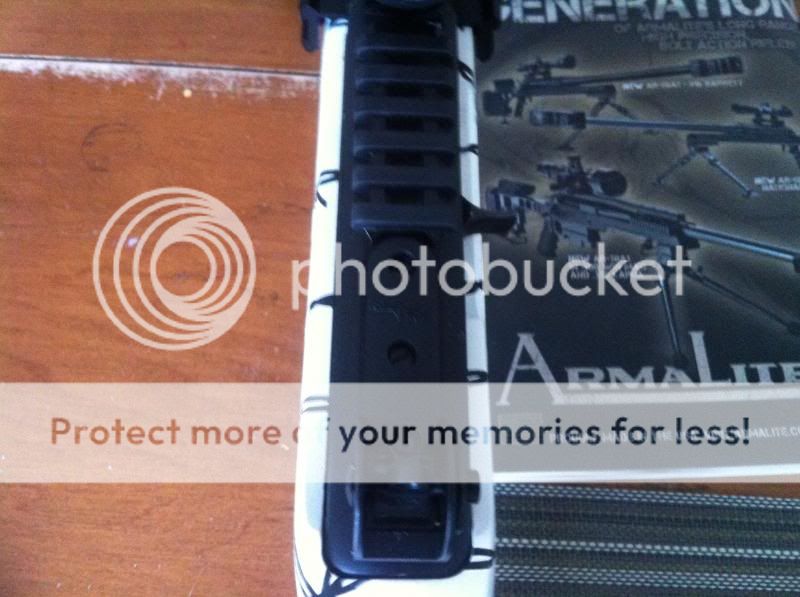

The special things about this project is the fact the the lower part of the rail is permanently attached to the stock and the upper part doesn’t touch the barrel, so it’s free floated.

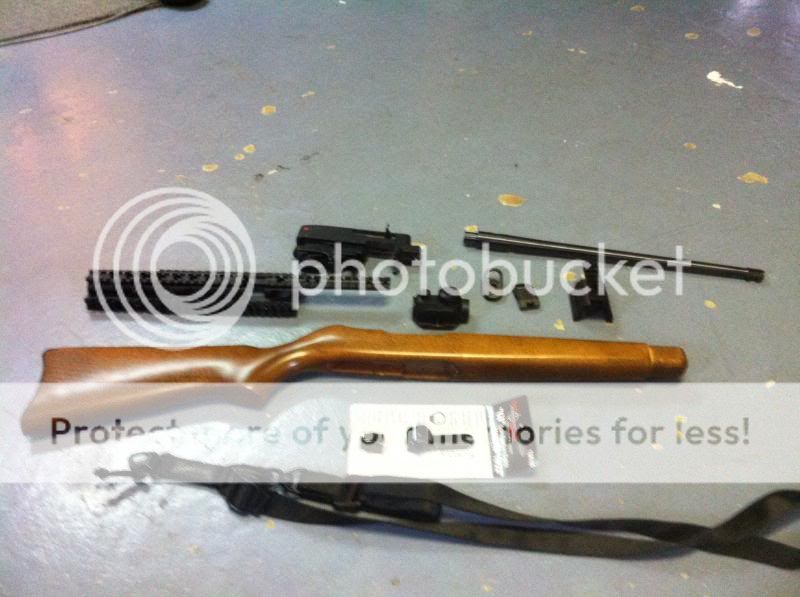

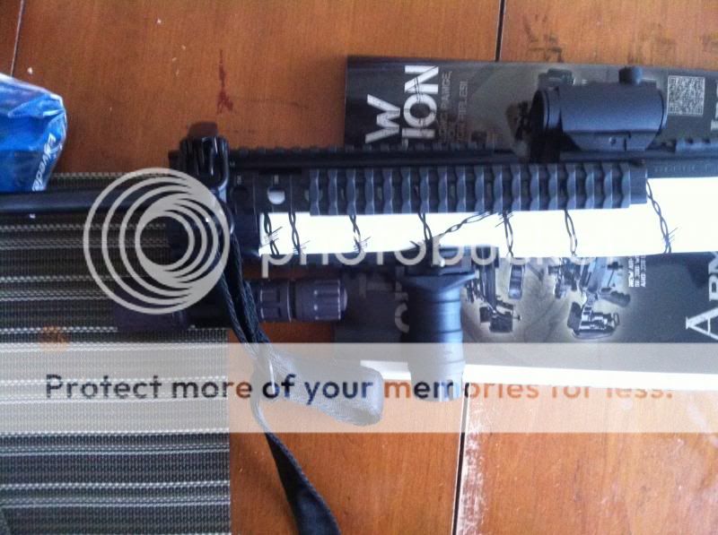

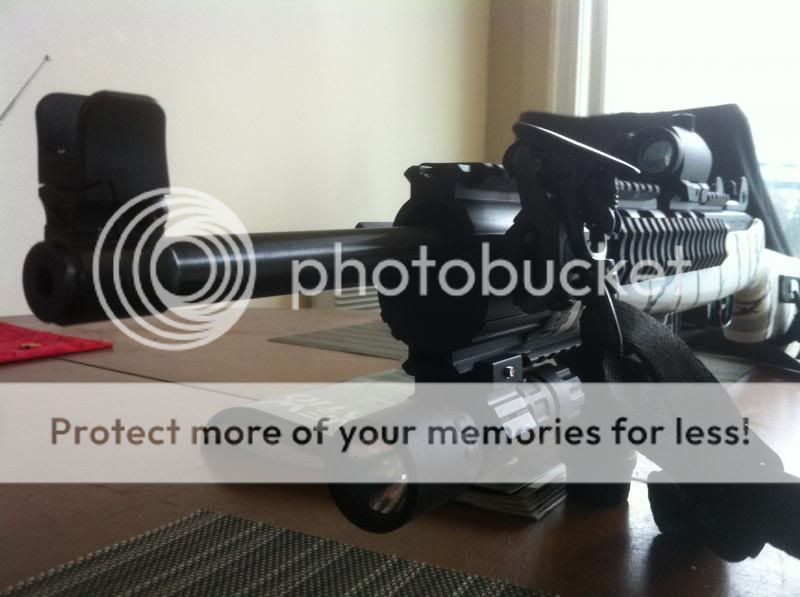

Parts used :
10/22 action with 16.5’’ barrel

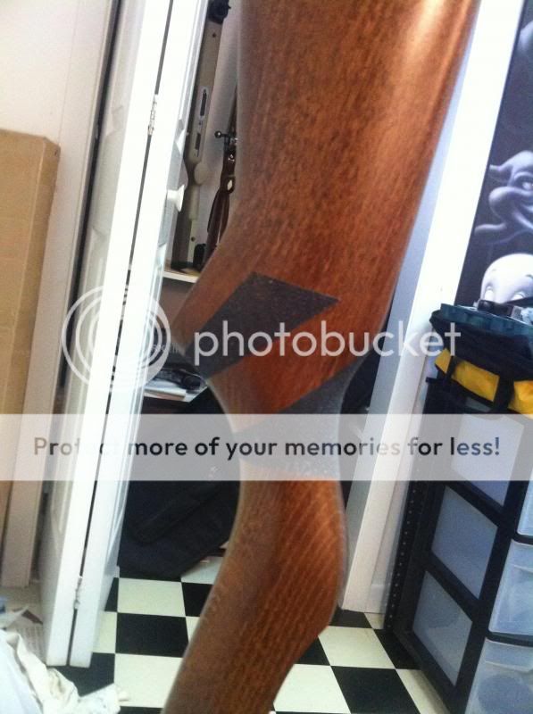

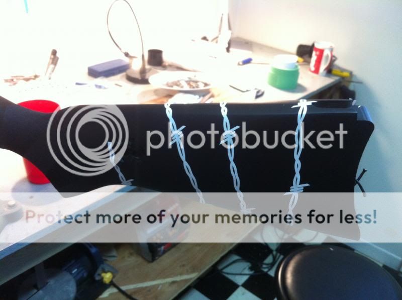

Wood stock painted using Alumahide and krylon and bulldogarms template
VQ trigger
Extended mag release
UTG commando rail (modified)
Rubber rail cover
Tango Down VFG
10/22 Tech Sight
Magpul front and rear sling point (the rear one is attached to the stock)
Magpul MS2 sling
SureFire flashlight in a no name ring
Red dot (this one is replaced with a TRS-25)
Not shown is a Beamshot laser sight

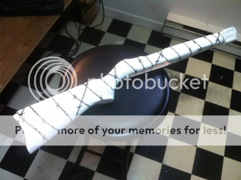

Now, the pics (in no particular order)
