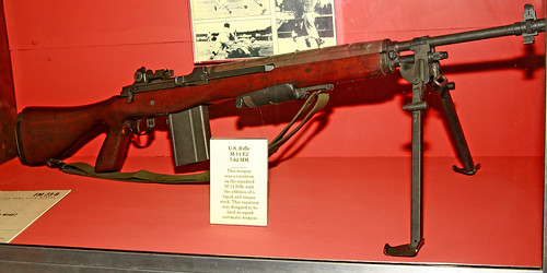

I have a USGI M2 bipod on my rifle. It's a heavy piece of duty kit, but a little ratley and I had to grind off the bottom of the legs a bit to keep it from digging into the stock, but I havent seen any m14 around my parts with the same bipod, maybe thats good or bad. I like it and will continue to use it.

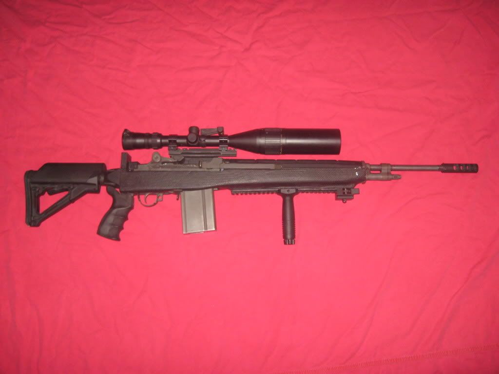

The best way to do this is to buy a small piece of cheesegrater (ie. picatinny rail) that replaces the sling mount. I got one from fulton armoury that has a little cheesegrater with the sling mount at the back.

Agreed - but a long thick picatinny rail bolted on the bottom of the forend stiffens it enough to allow more forward mounted bipods with no POI shift -
More holes to drill though :)
As in below -
