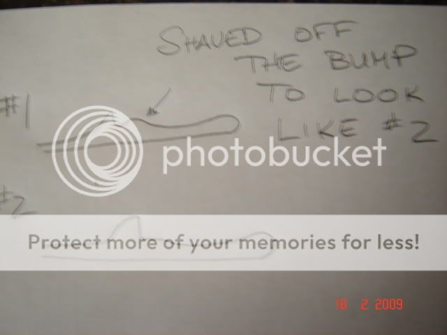

I can tell you I was having a heck of a time trying to figure out why the spent shell would not exit the gun. I fiddled with the extractor but that was fine. It wasn't until I noticed something wrong with the ejector that just brushed the shell off the extractor leaving it inside the gun and not firing it out. I filed down the bit of a bump just before the flat edge and it has worked as it should without fail ever since.
