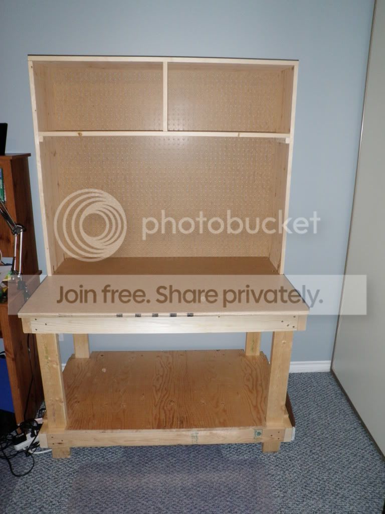

I just got finished building my bench. It's a NRMA bench, and the plans are available online. I am very new to reloading, just did my first 20 at a buddy's house, and haven't yet used my bench. It seems so well planed out though that I'm sure it will work great!
That is the sweetest bench I have never dreamed of. Man I would love something like that. Maybe I can pay someone to build it for me haha
I have an NRMA bench like Rancheroman's. Friend built it about 33 yrs ago, got divorced, gave it to me for 150.00. I have a swivelling/retractable arm lamp mounted to the top of the cupboard. Helps when checking powder height in cases. I have a MEC700 on the left side, a Rockchucker on the right. My scale sits on the shelf where it's at eye level. I took a Redding BR3 measure and a 24" Jorgensen clamp that I bent to suit, to mount the measure to, makes it portable that way, lets me take to the range to load powder for the Schuetzen rifle right at the shooting bench, and store it out of the way at home.
The main top is bolted to the support frame, making the whole thing a takedown setup. Have moved it twice over the years, very handy that way. The countertop on mine is 3 pcs of 3/4ply glued together, the whole frame is 4x4's. He decided to overbuild it a bit.
As it sits loaded up with gear, it is easily 1000 lbs, two of us couldn't move it, had to unload it to move it around the room.
