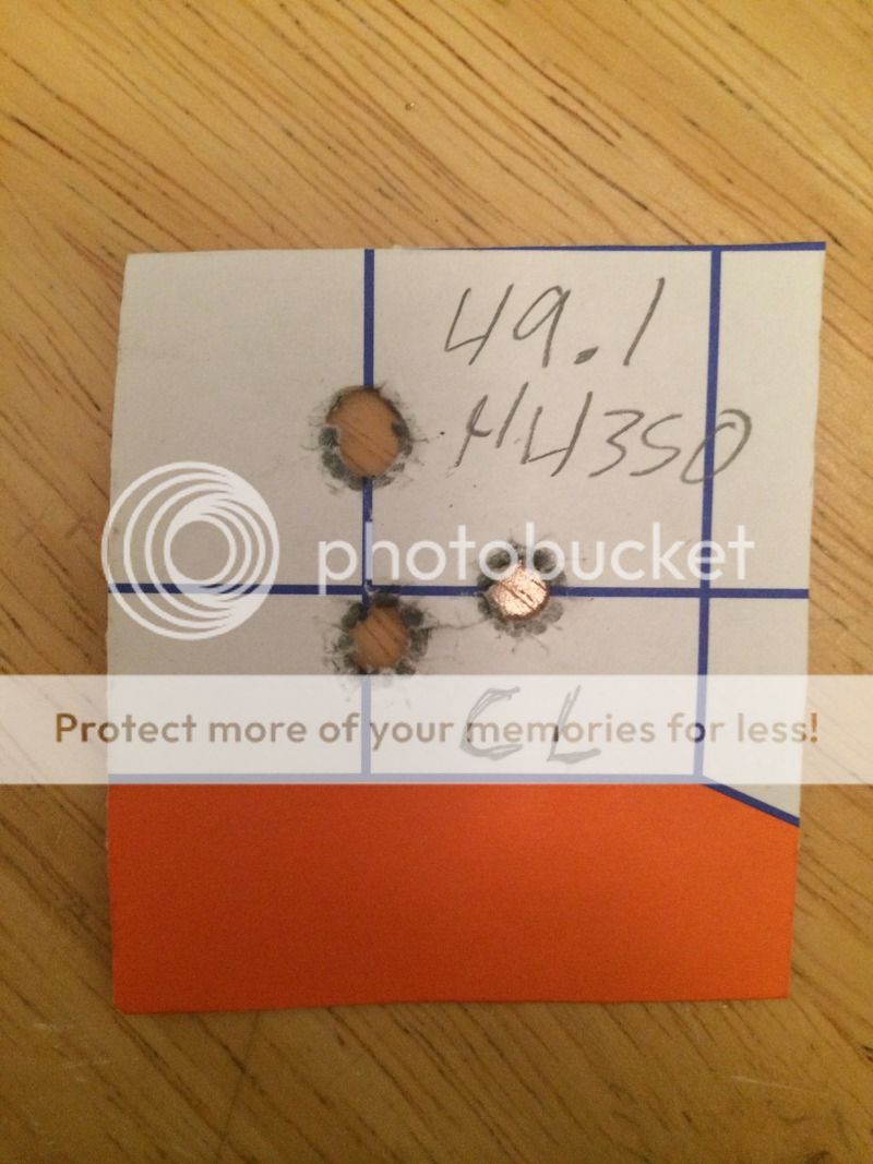

I rather enjoy the model 7.... Quite a treat to pack around and the one I had the pleasure of working with was superbly accurate... They are LOUD tho... And the stock forearm reminds me of something savage builds but if you pay attention to the barrel channel clearance it might surprise you... A stainless synthetic 7-08 was spotted recently in the EE with an asking price of $850, if not for another recent addition to my collection I'd of grabbed it.
Model 7 in 7-08
100M, shot from bag's
139gr Interlock over H4350
3-9x40 Bushnell mystery scope
