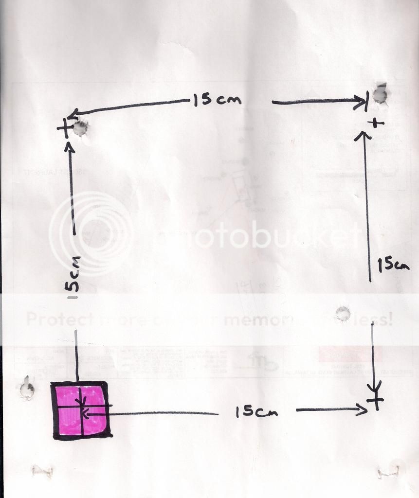

Here are some targets I shot today. Savage 10TR 308 Vortex HST 4-16x44 in MRAD. Bullets were 150g FMJBT Hornady and 46.0 g of IMR 4064. Targets were at 92 metres (about 100 yards).
First up, Box test. I aimed at the block outlined pink box (1" square) for every shot. For the first I dialled the scope up 1.5 MRAD. That is about 15 cm. Fired the first shot. I then dialled to the right 1.5 MRAD and fired the second. Then 15 MRAD down and fired the third, ( I did not feel good on that one...). Then I dialled 1.5 MRAD to the left and shot the forth. The black marker lines and measurements were put on after at home.

My only complaints are that the zoom dial is a bit stiff and at 16X the eye relief is a bit narrower than at 4X so your eye has to be in the sweet spot and that sometimes takes a few seconds.
