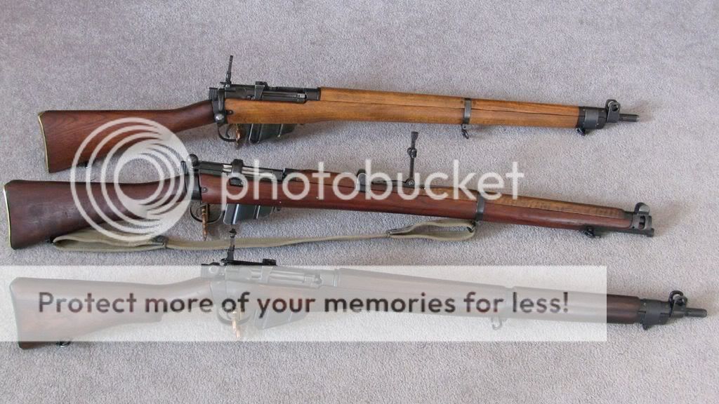

Just finished a couple of these this weekend.
I received them all as sporters.
the top is a british #4 mkI
Middle is a 1917 #1 mkIII*
Bottom is a Savage #4 mkI* dressed in new MKII wood. Do you guys know what kind of wood it is? It's realllly dark
All have been re-finished with BLO. I love how smooth they are when finished with BLO, like butter.
The pig sticker is like new, but it is marked No4mkI, not mkII. I thought only crucibles were MKI.
The savage has a 2 groove barrel, aren't they normally 5?

The one at the bottom: I found that often, with the new front hadguard, there's too much wood vertically speaking and that can hide the front sight when trying to aim. On two occasions I had to remove wood from the handguard to make it thinner so the view of the front sight blade is not obstructed. I'm just saying this because from the pictures, the hadguard seems to be significantly higher than the middle band.

That dark wood is POF made walnut. Also, it is not proper for your gun since you have a MkI* and it's MkII wood.
Good pick Claven I hadn't read the description well enough apparently. Doh.
Does make me wonder how it was fitted and how well that can stand the stess of shooting. Macadoodle, what did you put as a "spacer" in the middle where the screw goes through the forend, at the rear of it? Otherwise, the screw would squeeze both sides of the forend together, putting stress on the wood where it shouldn't? Because normally the screw makes the two sides contact the part that holds the trigger in place in the Mk2 (and Mk 1/2, 1/3). Not sure if my description makes sense,

never really thought about that much. I found that the receiver and the trigger guard held the wood apart, while the screw holds it together. Seems really solid to me, no flex or anything, but a small wood spacer stuffed in there may be a good idea. I have shot it a couple times and haven't noted any issues.

the new hand guards had tones of wood that I had to take off on the bottom, just so I could put the bands on. Using "new" wood isn't as easy as using "used" wood. No problems with the sites, but i would like to figure out how to bed the barrel properly.

Bedding the barrel is properly done by inletting a hardwood block into the stock that is high enough to provide the correct upward pressure on the barrel. Apparently it's a black art. I tried to find someone to do the same to my rifle and there were no takers.
I've seen a few stocks, from all of the makers, that were too flexible to bed the barrel properly. Also, a few Longbranch ranger rifles where the upper handguard was contacting the barrel, and the barrel was free floating in the forearm. No problem using the Mk.2 forearm. Just don't tighten the transverse screw too much. One mod that I've made to a couple of No.4 rifles was to bend a small lip in the upper band, to keep the top handguard from moving forward. Bedding the No. 4 is a snap, compared to setting up a Mk.III! After fitting up three brand new Mk.III forearms, I decided to sell my remaining supply. Gives you a whole new respect for R.E.M.E. Armourers!
