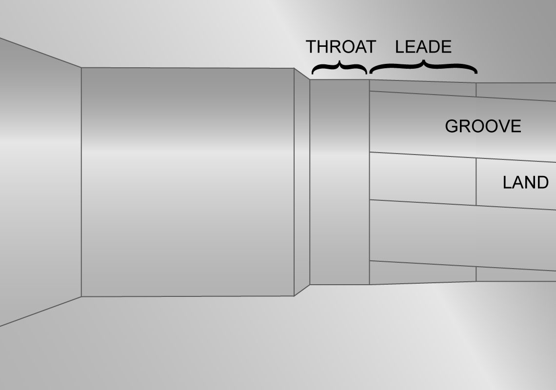

for reference
Great pic. Thanks

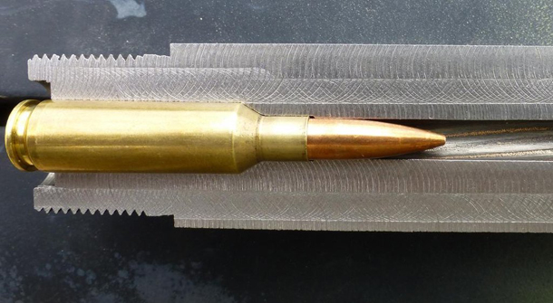

Right where the silver band is ahead of the fire checking, is that the throat and the lands start just ahead of that.
Thanks for posting the picture. I always wondered what it looked like.
The Leade was where that band resides. Depending on the cartridge the barrel was chambered for it could be from .030-.076. Go No Go will be dependant on how tight your chamber is compared to SAAMI standards. I have 1 204 Ruger that is so damn tight, It gets it's own settings for dies and absolutely cannot be used in another firearm, and then reused/resized to the tight one.
One fine day, I will purchase a piloted finish reamer and bring the chamber to a tolerable spec. This one rifle is how I got my start in reading up on this and applying it in the field.
Right where the silver band is ahead of the fire checking, is that the throat and the rifling starts just ahead of that?

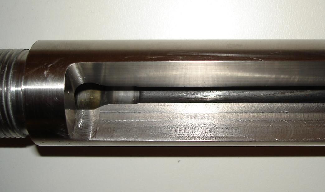

Look at the picture VERY carefully. See where the cut of the barrel is... the straight lines, look real close and you can see 'stairsteps'... those steps are where the cutting tool cut through the rifling along the bore axis. Allowing for a secant ogive bullet, take a good look.... there are NO stairsteps along the bore for 1.25" from the case mouth. This barrels is pretty much shot out. You can also see the coppering left from engraving... see how far that is from the neck? That is how far the erosion has gone. Almost 2 inches!!!.... nope, can't chase the lands any more......
Thanks Got Juice? appreciate that. Now I understand what guys have been talking about when they say that they have a barrel cut to certain dimensions and what a shot out barrel looks like.
