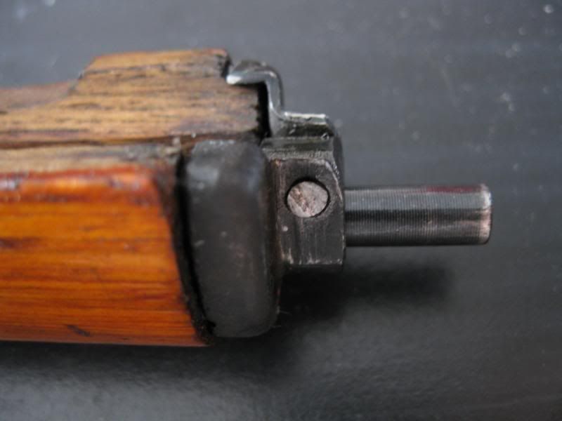

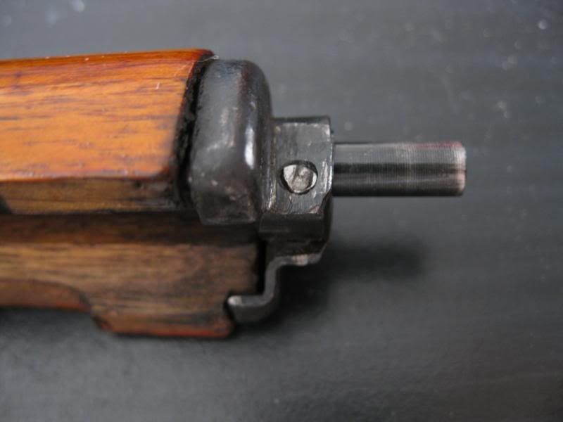

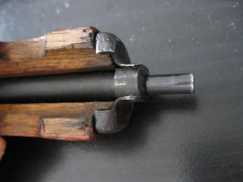

So I got a wonderful deal on a free stock screw from one of the members here, and that screw tightened up my rifle quite a bit. While that member and I were talking, we spoke in lenght regarding tightening up my sks and where I should begin.
I enlist the help of all those that have come before :)
Firstly, I'd like to focus on my gas tube.
http://i69.photobucket.com/albums/i75/slushee1234/IMG_0057.jpg
http://i69.photobucket.com/albums/i75/slushee1234/IMG_0058.jpg
http://i69.photobucket.com/albums/i75/slushee1234/IMG_0059.jpg
I'd like to punch out the pin that is retaining the handguard (as its loose and wiggly) and try replacing it with a new roll pin to see if that will help tighten up th ewood. Has anyone done this before, and what pin would you suggest I use (solid pin vs roll pins and what sizes). Also, any direction easier to punch out the pin?

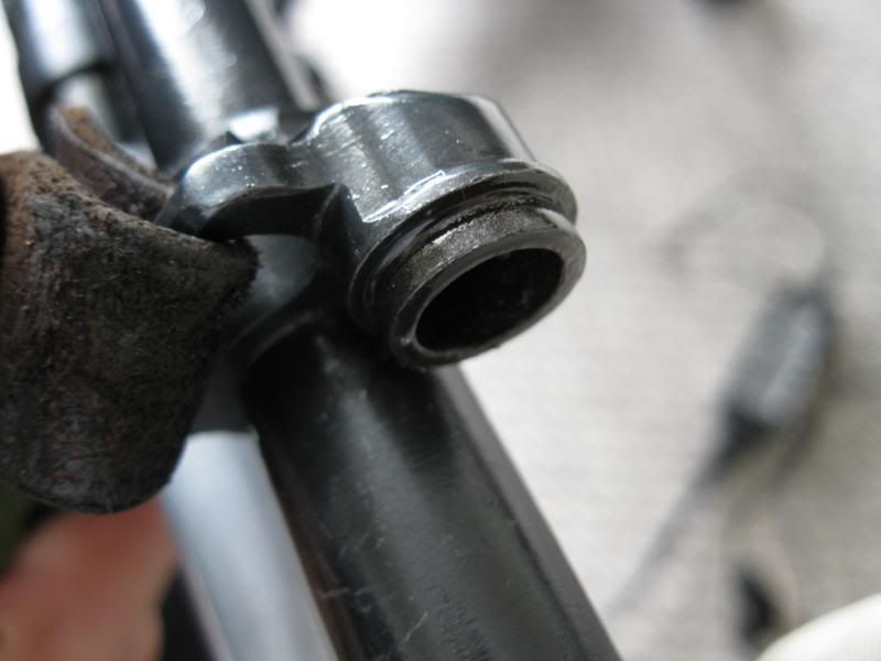

Secondly, I'd like to place a small black oring on this part to tighten up the slop in the gas tube (as I dont have the ability to drip a bit of weld on the back end of the clip that holds the gas tube in place by the lever on the rear sight). Does anyone know of the right size oring and where to fine it?

"O" rings won't last very long. If you do end up useing them, go for the brown heat resistant "Viton" type. Hot gasses will quickly deteriorate the black "Buna N" type.
Any idea who sources those brown ones? Am I looking at home depot/canadian tire, or more like a 'regional hose' store that specializes in rubber?
I don't think that sealing the gas escape port is a good idea, that will put a higher pressure on the piston and it may get stuck in the tubel the two holes in the tube behind the piston head are gas bleed holes, the main exhaust it at the front that you want to seal.
http://i69.photobucket.com/albums/i75/slushee1234/IMG_0060.jpg
He's talking about the connection from the gas tube to the gas block on the barrel, not the gas escape port.

Slushee, I agree with your logic. why not try a dab or 2 of black loctite, it's like liquid black rubber? I'm in oilfield and we use it for various things including contact with gases. It stands up well and you can administer the exact amount you need and add to it if desireable. This may not work, but you might consider it.
