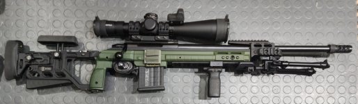

I bought a used CTR, sold the cheapo factory stock, threw the barreled action into a KRG Whiskey Gen 6 folding chassis with a Trigger Tech and have never looked back nor regretted my choices for an instant. All Tikka Barrels are warrantied to shoot MOA or better, and I consistently get .75 MOA out of mine with factory SAKO 143gr 6.5 CM bulk FMJ ammo. It would no doubt do .50 MOA or better with handloads, but I don't have the time or the space to get back into handloading right now. In any case, you will not go wrong with a Tikka, regardless of your choice. Get the barreled action that you prefer and ignore the Stock, as you will likely sell it off in favour of an MDT or KRG after-market Chassis or adjustable Stock anyways. You simply cannot beat the glass-like throw of a Tikka action. Not without spending big custom action bucks, anyways.....

If no muzzle brake is wanted, consider the varmint and put it in an MDT chassis and switch to AICS mags.
I appreciate your and others suggestion of an aftermarket chassis. While I was not really considering that option, the more people that suggest it, it makes me think that there may be some added value in it.
Now, I am looking at options.
There may be project here after all.
