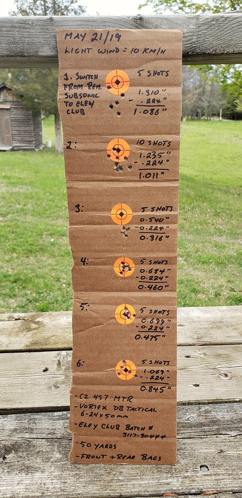

No big difference to argue over. I personally wouldn't worry over 4". I have a 16" CZ 457 MTR and hitting 8" gong at my 280 yard shooting lane with easy AND nice a compact for my shooting needs. As for looks and overall balance between a 16" or 20" barrel with a 6-24x50mm scope mounted on top will be personal preference.
