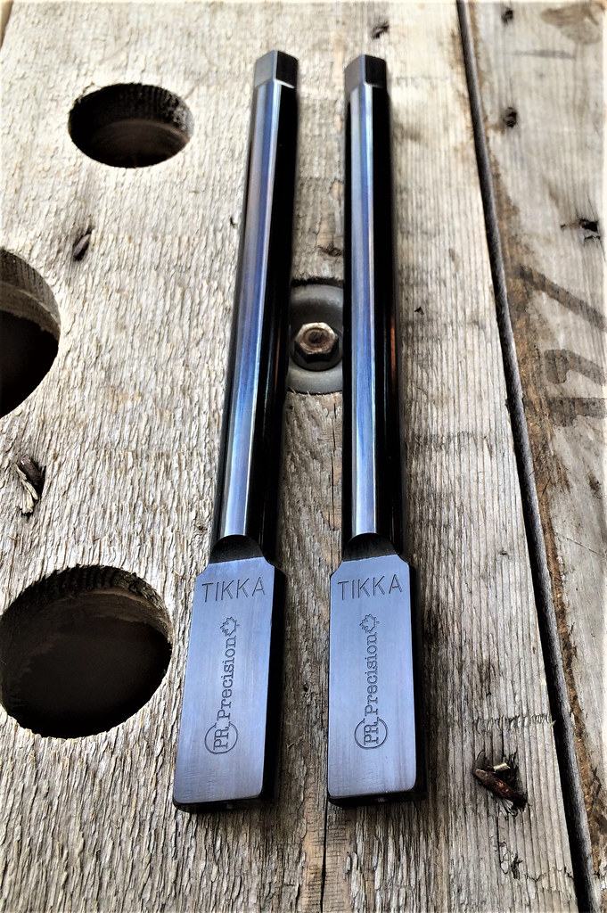

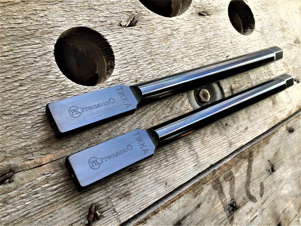

You must have got a good one, they sent me one so out of spec the lug will slide into the action but the main body of the wrench will not slide into the action, thus the lug does not even come close to butting up to the barrel where you want to apply the pressure to tighten and loosen the barrel, so far they've ghosted me on 2 phone calls, and the reply to every email is call us right away to discuss this..........anyone want a nice paperweight?
Photos as promised. These are made from 4140 and are hot blued
Absolutely beautiful craftsmanship! Your bluing is so nice, maybe Someday you could show some of the gun companies how it’s supposed to look. Love the maple leaf also.Kudos
