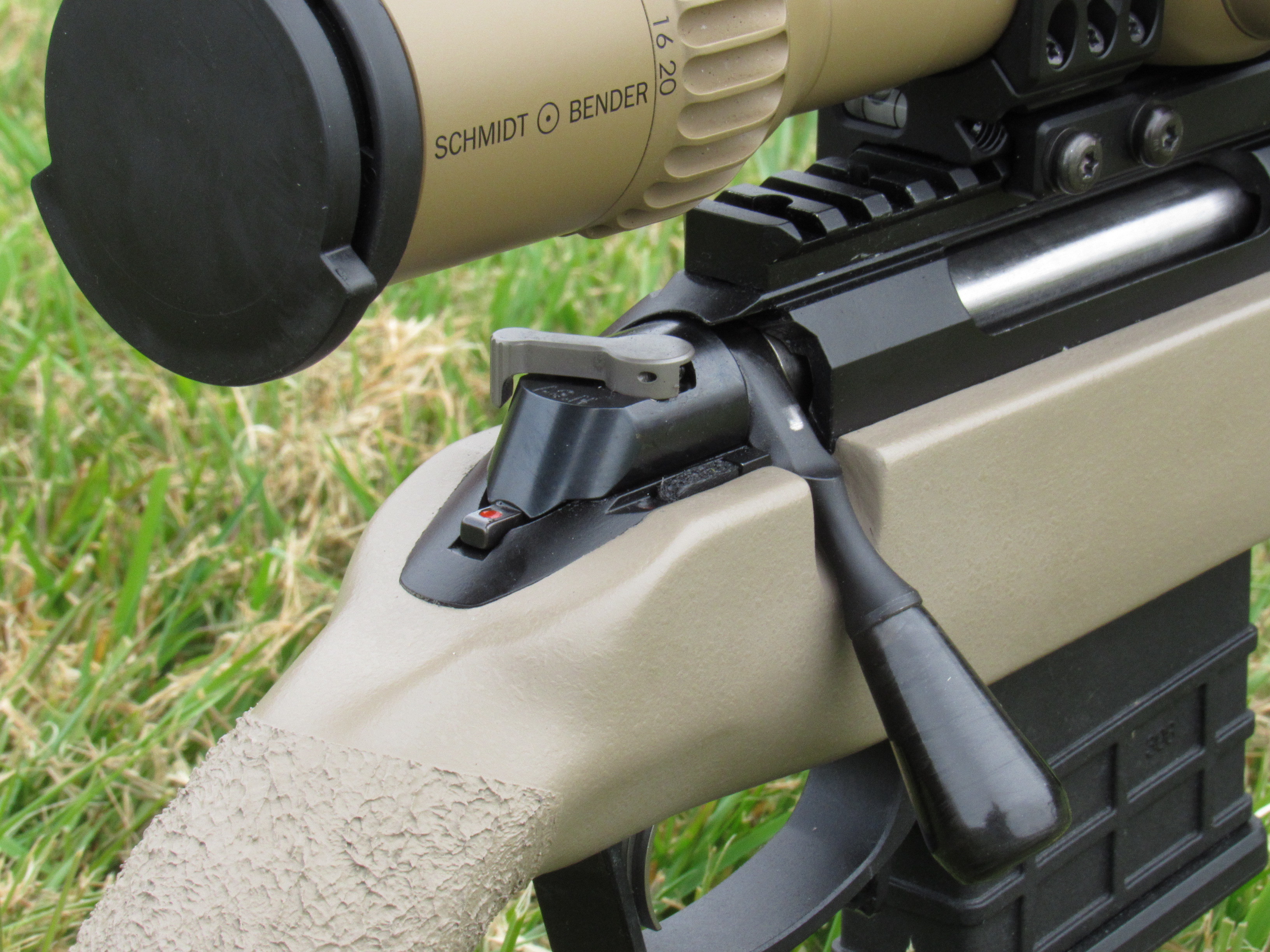

Here is my modded t3
Superlight (fluted) McMillan hunters edge, Leupold VX6 3-18x44 in talley lightweigts, B&T lightweight bipod, fluted bolt. Tried a stainless bolt shroud, but a buddy had some failure to fires. Worked well on mine, but cost him a coyote so I switched back to the plastic.
