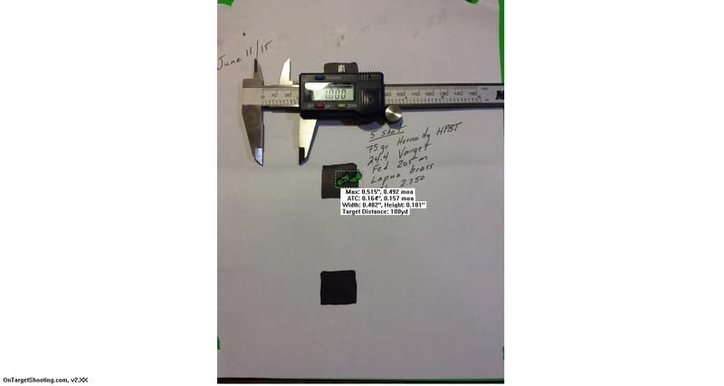

I posted the same topic back in Feb. and ended up buying a Tikka T3 Varmint .223. This factory rifle can easily shoot .5 and even down to .3, its incredible. Im trying to do the .5 moa challenge and get 4 groups .5 then my nerves get me and my last group opens up.
Tikka rifles just plain shoot amazing...no ejection issues like Sako, all sorts of aftermarket parts from Australia for cheap. Installation of parts like tactical bolt knobs are done at hom ein about 30 secs.
Best upgrade you can do with these rifles is loose the factory mags and buy Atlas Worx bottom metal for use with AI mags..you can seat 80 gr SMK's out as far as 2.500 They shoot amazing!!
I did a quick zero today before I go out tommorrow for varmint shooting but this was my group....none of my rifles shoot this well.
