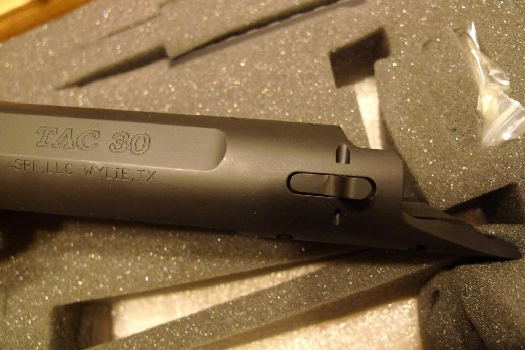

I was planning on ordering a timney 1.5-3.5 trigger for a stiller tac-30 action and i was reminded that the Stiller has a side bolt release on the action itself negating the need to have the bolt release on the trigger itself like the normal rem700.

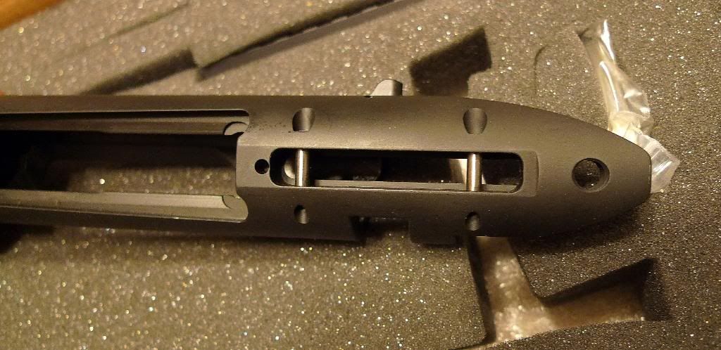

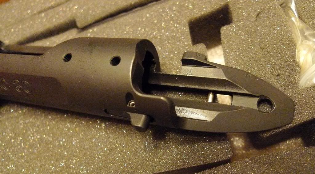

I'll take a look at the action and see what the bottom looks like, hell i'll take a pic and post it

The TAC 30 is not milled to take the 700 bolt stop. The 700 bolt stop release is removable from the trigger housing. It would not need to be removed but it would not be functional.
