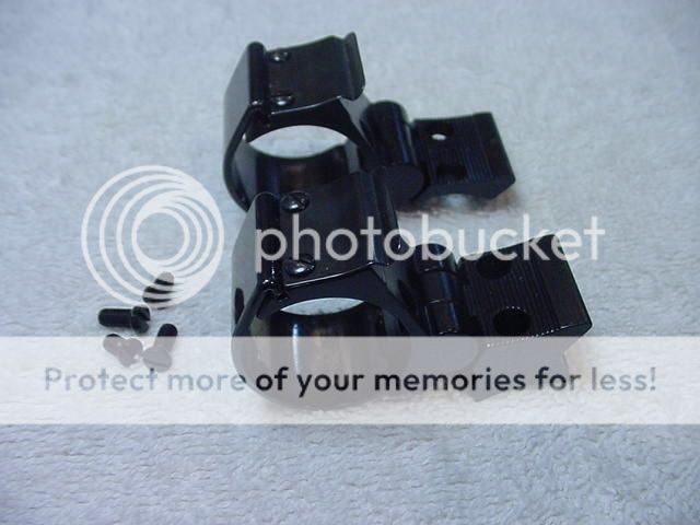

The name Weaver used for them is Weaver Pivot Mount. Here is a set that is in excellent condition.
Most of the stories you hear about them being unreliable come from people who never used them. I have used them quite a bit, and buy every set I can find. They are very solid on the rifle when set up and adjusted properly. Every set I have used returned to zero properly. I have shot numbers of small groups, while swinging the scope over and back between shots, to demonstrate so.

Those are the same ones I have, it has a Weaver 2.5-60 scope on it at the moment. They too are in pretty nice condition.
The first set I had came on a model 4000 Husqvarna LW in 30-06 I inherited from my Dad. I've had good luck with them and have since also installed them on my Marlin 444S, Marlin 1895GS in 45-70 and a Husqvarna model 3000 in 270 Win. From the applications and situations I've used them in over the years I've found as long as you keep the pivot screws snug and make sure the mating surfaces are clean prior to positioning the scope back into position, no problem. However, even a spruce needle where it shouldn't be when repositioning the scope will throw things out of whack significantly.
