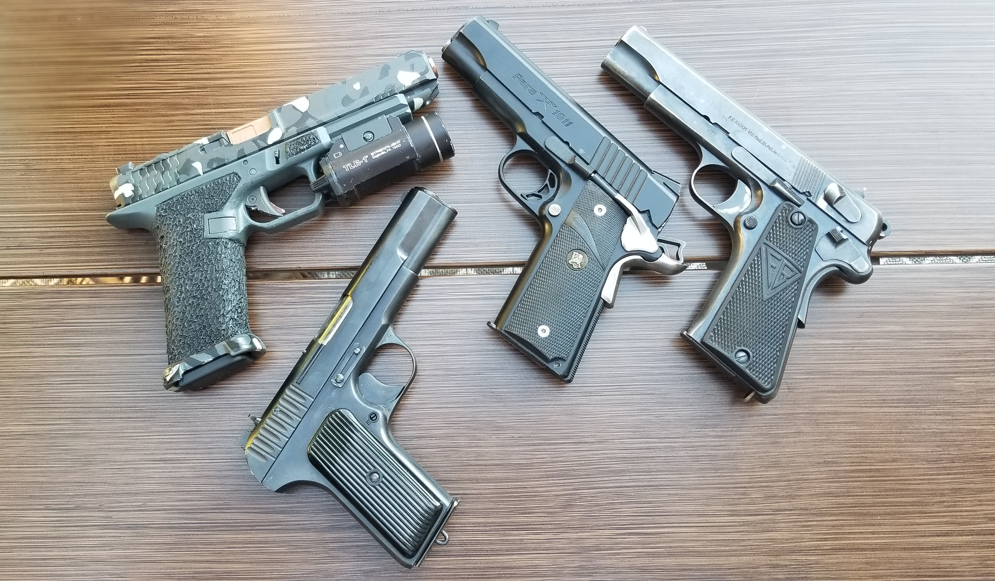

Regarding paint - I've done a number of stocks and I found that Krylon (especially their flat camo color series) works very well. Do not use stuff like Molotow - they have an insane amount of colors and I used them to paint my Glock 34 for this reason as I wanted to so a cheap urban camo. The paint is thicker and chips much more easily compared to Krylon, which also dries faster and is easier to apply
6PXR3Pn
. If you want to do stencils, I found that putting painters tape onto wax paper is a great way to make DIY stencils. You can draw on the tape using a pencil or marker and then use an exacto knife or scissors to cut them out. It's pretty tedious but it pays off if done right! See picture below.
