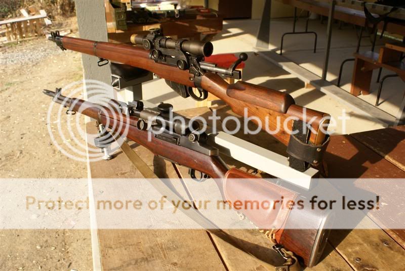

After you get your first Garand, then you'll want something with a scope, like an M1D:
Yes, mine is a Danish M1D. Springfield Armory. Has the Hart Flash Hider (funnel shaped) as well.
Optics are like New. Crystal Clear.
Picked it up from Districorp when the Gunrunner Newspaper was still in business.
When you pull back on the charging handle, look at the right side of the barrel/chamber where the cocking was when closed. If you see a tiny crown, it is a Danish barrel, so the gun is one of the Danish Lend/Lease rebuilds that came into Canada about 17 years ago.
The Danish barrel maker was VAR. Very well respected amongst shooters in the Excited States of America - when they are not slagging anything not USGI. The Danes also had Italian BMR and BMB barrels. I forget the exact other markings on the Italian ones.
The M1D rifle was fitted with a unique barrel with an integral base for the M1D scope mount. M1D barrels were ALL made by Springfield Armory and have a different drawing/part number than the regular Garand barrels. The Danes did not make any M1D barrels. Their M1Ds were fitted with the US made barrel. The Danish made VAR barrels have an excellent reputation for accuracy.
