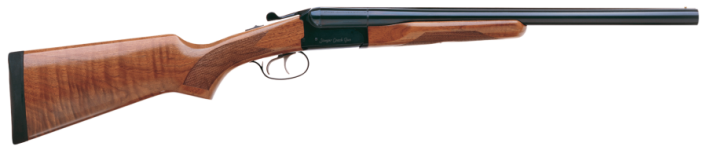

To build Stock for Coach Gun Supreme Shotgun
qcdude
Member
6   0   0
Montreal
Stoger makes them ambidextrous. So in my case (right handed shooter) shots tend to land a bit leftward. I was thinking of bending the original stock to get enough cast off, but then concluded that this idea sucks. As in most cases the wood tends to straighten up back anyways with some time a while after.
I'm also open for an idea of getting a ready to install solution. But I can't find any...
So at the end I decided to carve my own stock. I've had some wood work experience in my past, so I feel like I can do it.
QUESTIONS:
where can I buy a suitable piece of maple wood or a similar of about 17x6x2.5" size ?
I'm also open for any other kind of solution.
