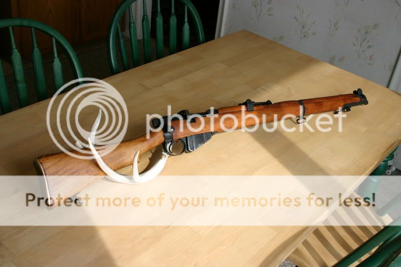

I have a very good condition Lee Enfield GR BSA&C 1916 STHLE No1 MKIII, sporter, that I would like to restore to it's original condition, but prior to do so I would like to know if there is some specifics info I should know about it, can it be done on any Enfield rifles, and where would be the best place to find parts to redo it?

Bore looks good and the SN on the bolt matches the receiver, Barrel is the right lenght, Looks like it's good to go, i'll let you knon, when I'll be restoring it. Here is what it look now.
