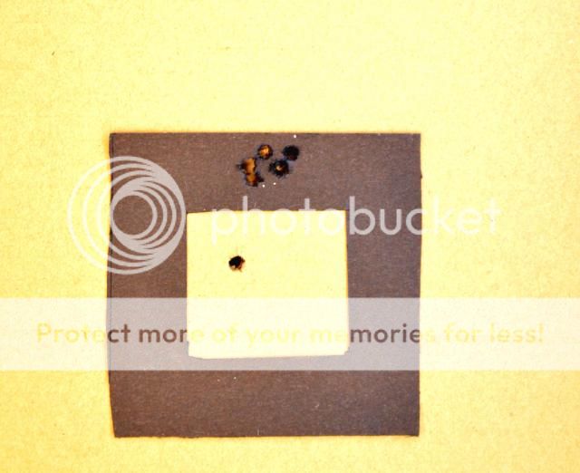

Put up two aiming marks, my usual black squares, on a piece of cardboard at 100 yards. I set up the chronograph and proceeded to shoot. A fouler, then five on target, one after the other, so the barrel heated up, with the 70 grain Noslers.
My first fouling shot, from a previously oiled barrel went 3439 fps, while the next five averaged 3537 fps.
And here is the target, showing the five made about .6"

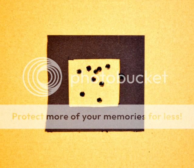

I still had ten of the Remington 80 grain factory loads to fire for the brass, so I sat at my rest and fired all ten, with only a slight pause at five. The barrel was so hot it would have burned my hands if touched and I was getting some mirage in the scope. The scope by the way, is a Bushnell Elite 3200, 1 to 4.5x, set at 4.5. And here is the target of those ten. The centre light colored area is 2 inches square.
