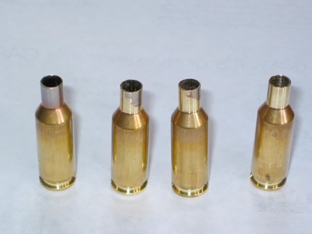

I grew-out of the idea that tight necks and thinly turned brass were the panacea to accuracy, however i still strongly believe that cleaning up necks is an important step.
Before getting to this step, i use a neck turning expander mandrel that opens the cases just enough to allow the turning mandrel to accept the cases with zero slop.
I have a photo of 4 pieces of brass from the same batch. The case on the left is a virgin case and clearly shows the patina from the factory annealing job. The two middle cases show that in spit of setting the cutter to remove just under a thou of materal, the case necks are irregular enough in their consistency that the cutter did not touch some of the thinner areas. The case on the right - from the same batch and with the same cutter adjustment - cleaned up completely with no exposed low spots.
I firmly believe that cases that are not concentric will seat the back of bullet off the axis of the bore and this can affect long-distance accuracy.
