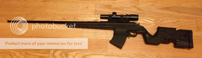

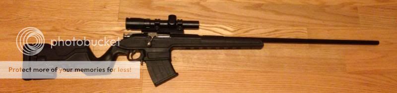

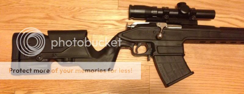

Todays project: Mosin Nagant archangel stock
jordanmalmal
45   0   0
Ontario
Fits great! Free floating barrel! looks awesome!
Now to find out why the 5 and 10 round mags don't feed correctly.....

Mine feed fine but I know with my ATI stock I had to inlet around the ejector. Just push on the ejector to see if it is recessing all the way back to let cartridges feed. May have to do some sanding.
I have the ati scope mount. Have to drill and tap then weld the bolt.. pics will be up when its done..
Anyone having problems with the archangel mags?
I had problem feeding with a 5 rounder when I 1st got it. the 10 round functioned perfectly. Hi Cal sent me a replacement 5 rounder that works as it should. There were known issues with the early batches. do a search on youtube for ArchAngel mosin and you'll see the company explain the "fix". requires nothing but an oven if memory serves.
