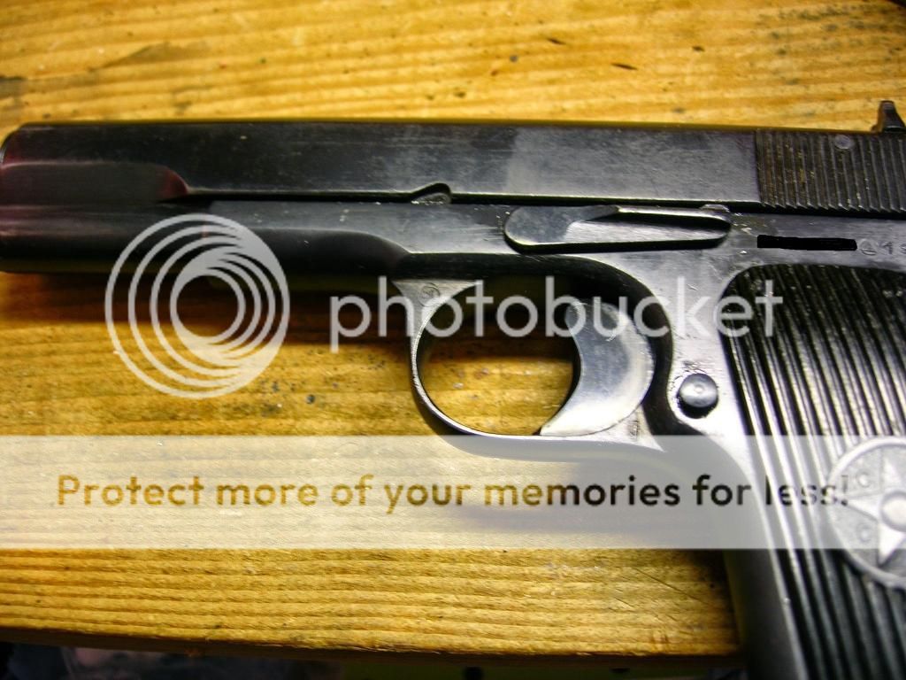

I received my Tokarev TT-33 the other day and the finish on it is interesting. It looks like it was half dipped into some cleaner or something that faded/coated the rear half of the handgun including the frame/handgrip area. Here is a pic of it. I have tried everything to try and get the film off, but I don't think it IS a film after trying everything in the way of solvents, cleaners, etc etc. Has anyone else gotten a Tokarev or other pistol that looks like this? It's a grand old war horse, so I don't really mind, it's just strange that it's half shiny blue and half flat. :confused:
I'm thinking that the dull area is the result of some initial rusting. It's the sort of dulling that you get when it'll just start to form a reddish blue look then gets cleaned and oiled.
Or it was subjected to something like Simple Green and left sitting half submerged in the bucket for too long. The simple fact is that Simple Green IS lightly corrosive to steel. So an overly long soak in the stuff could easily result in this sort of dulling.
How long is too long? Depends on the strength it's mixed to and the time in it. However I do know that folks with bicycle chains that left it sitting overnight in full strength SG to de-grease them found the link plates pitted and the rollers a dull grey the next day.
I've got the same marks on my TT33, but not as noticeable as yours. Also has a scuffed area on the slide around the front sight, some scuffing on the sides as well. The above ^ explanation makes sense.

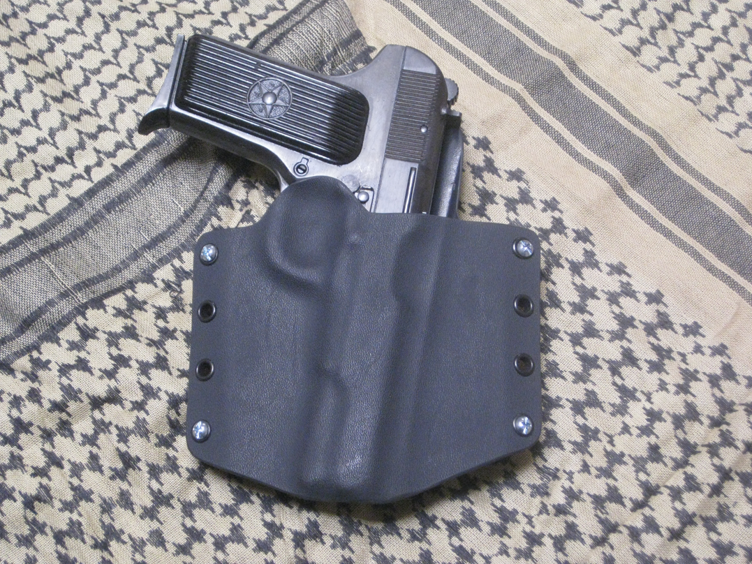

May have lived in a holster for a while and wasn't taken out so the front is cleaner, with shinier bluing???

It had a mix of polished and dull bluing when received.
In my case the dull bluing was a hard preservative that came off after a number of cleanings, reveling the polished blue underneath.

Only problem with that theory is the military holsters were full flap and the whole gun would've been covered up. The Tokarev is nowhere near a modern pistol for ergonomics or sights, but it was fairly cutting edge in 1933.
