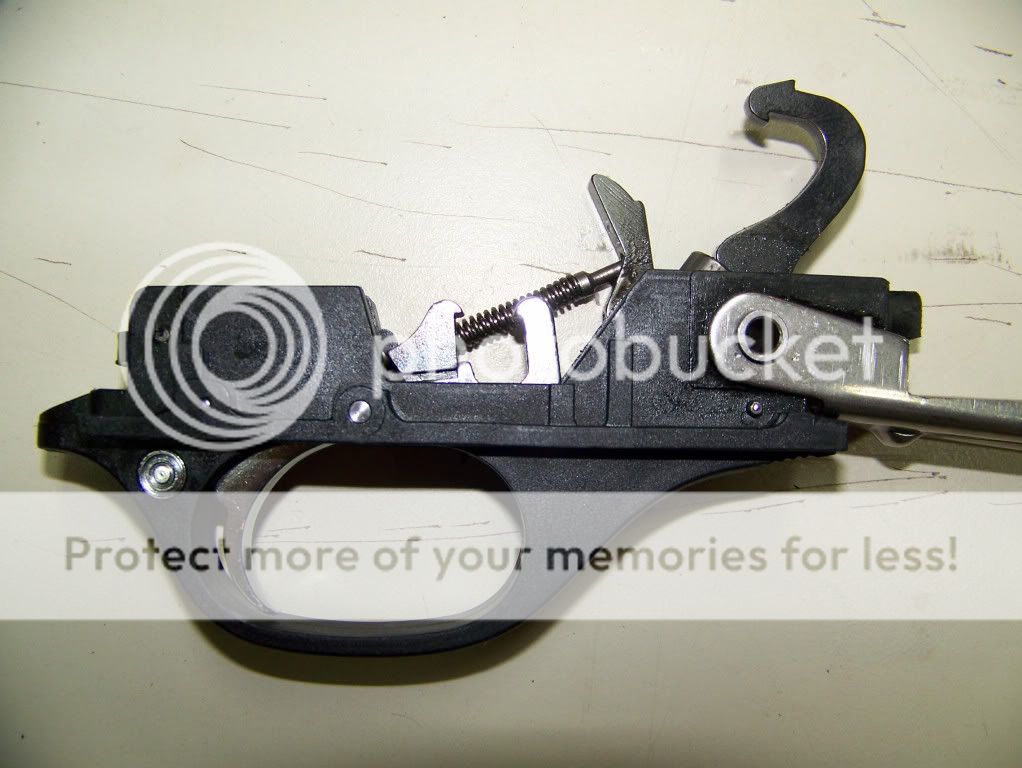

-the trigger and especially the safety are a lot better than the Maverick

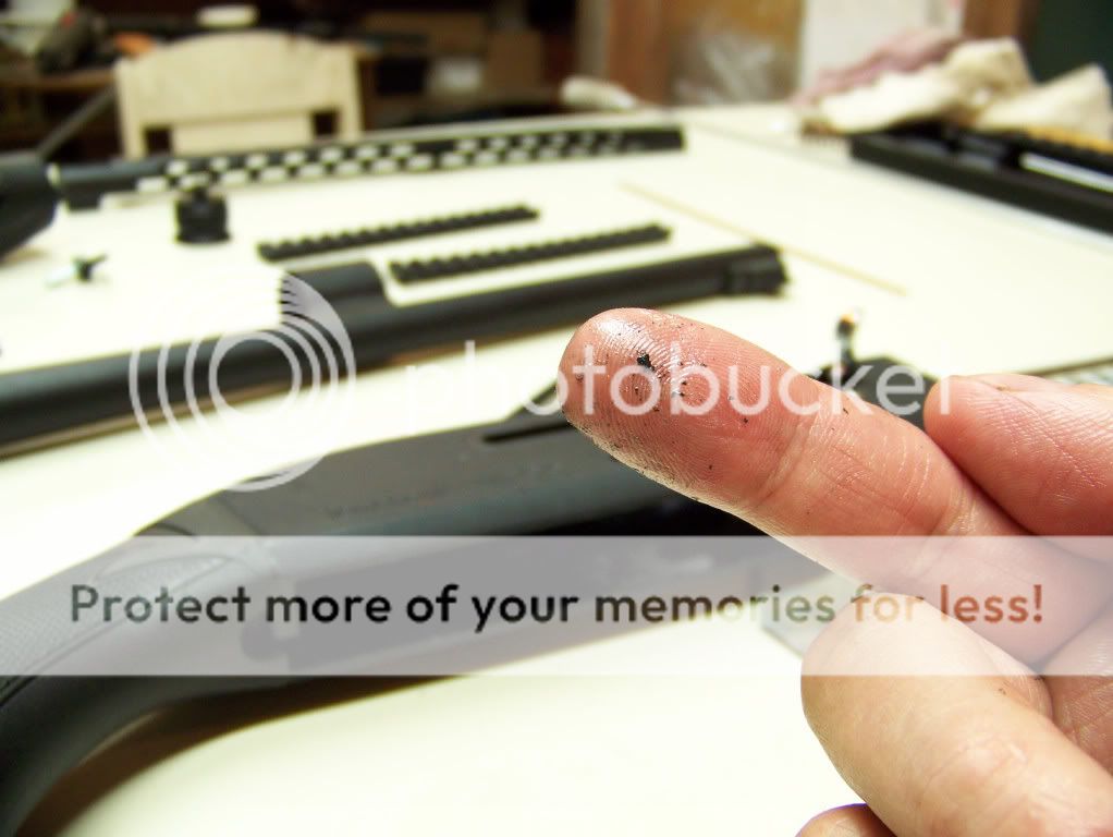

-The flat black finish on the barrel and the receiver is thin and scratches easily

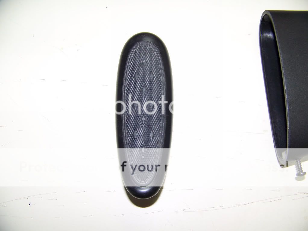

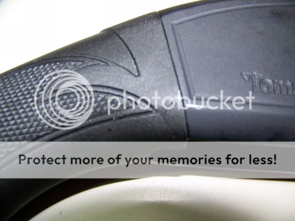

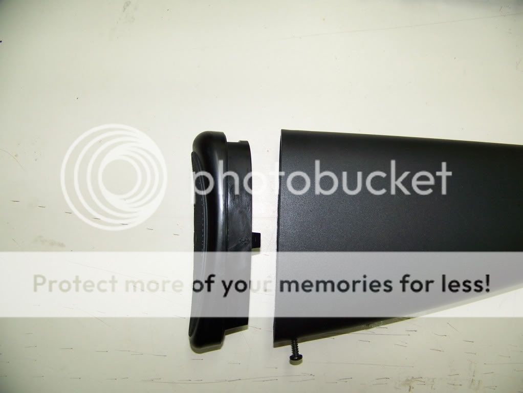

-The stock and the forearm are made of very soft and thin plastic, they also scratch easily,
but thet looks better than the maverick ones

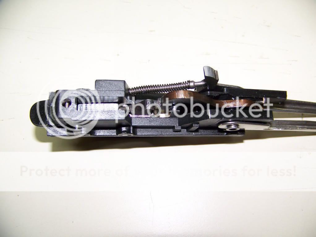

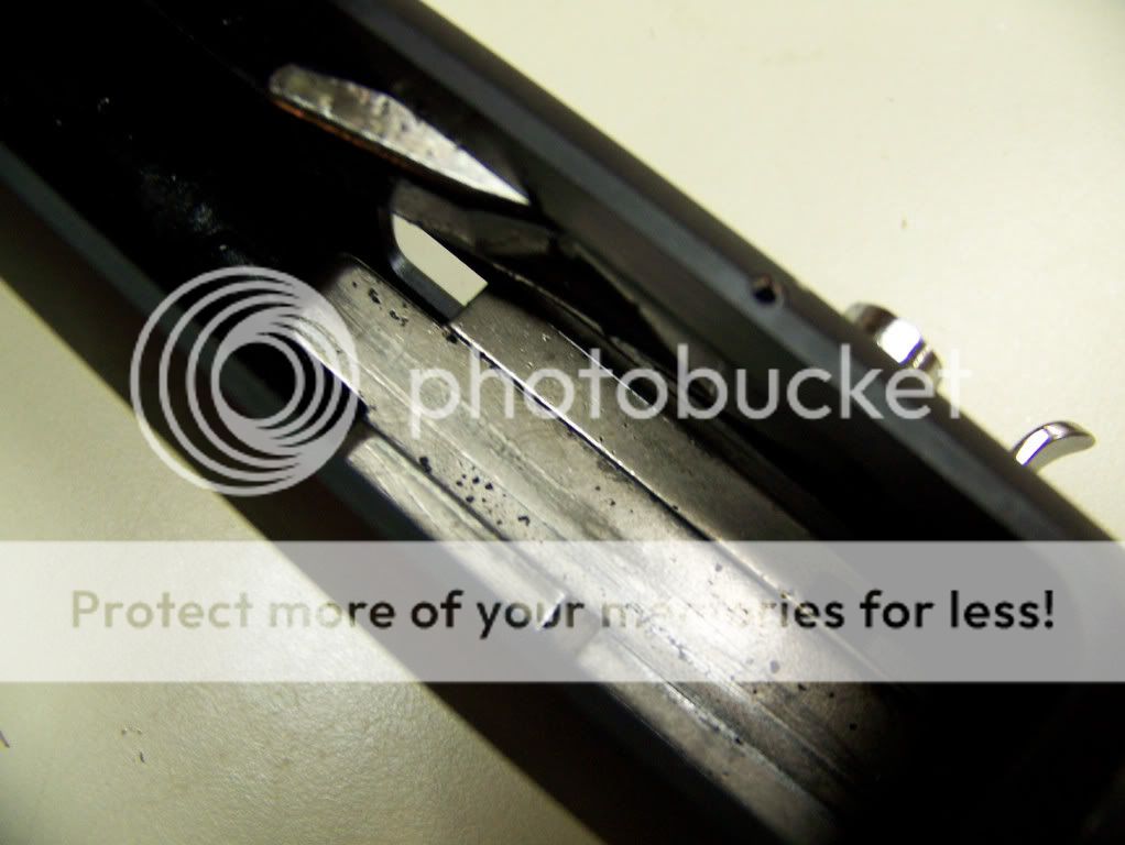

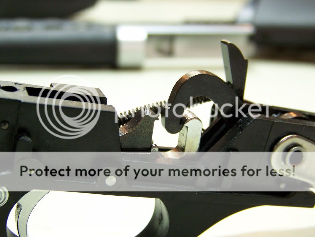

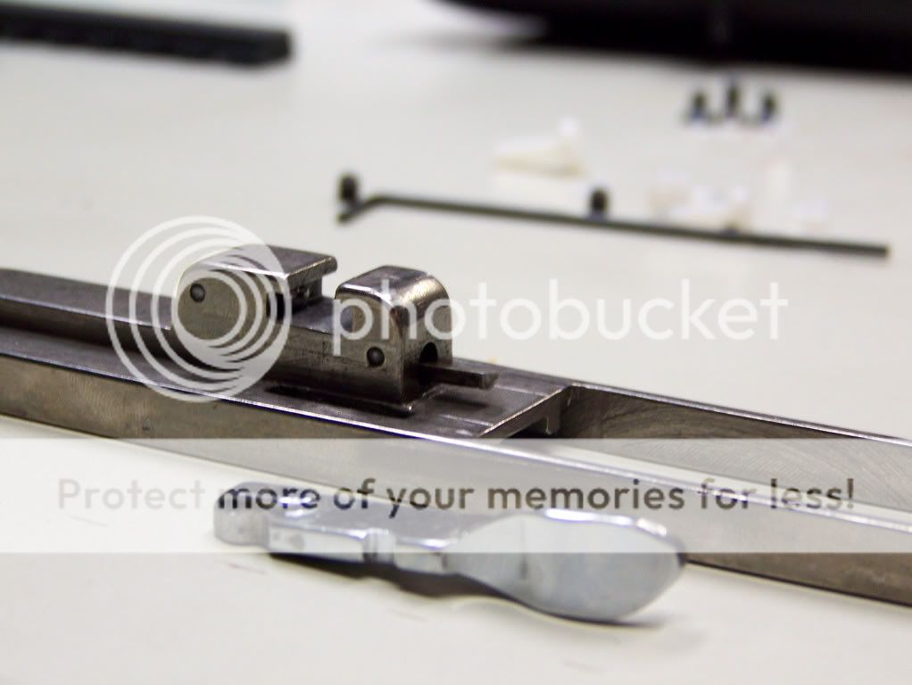

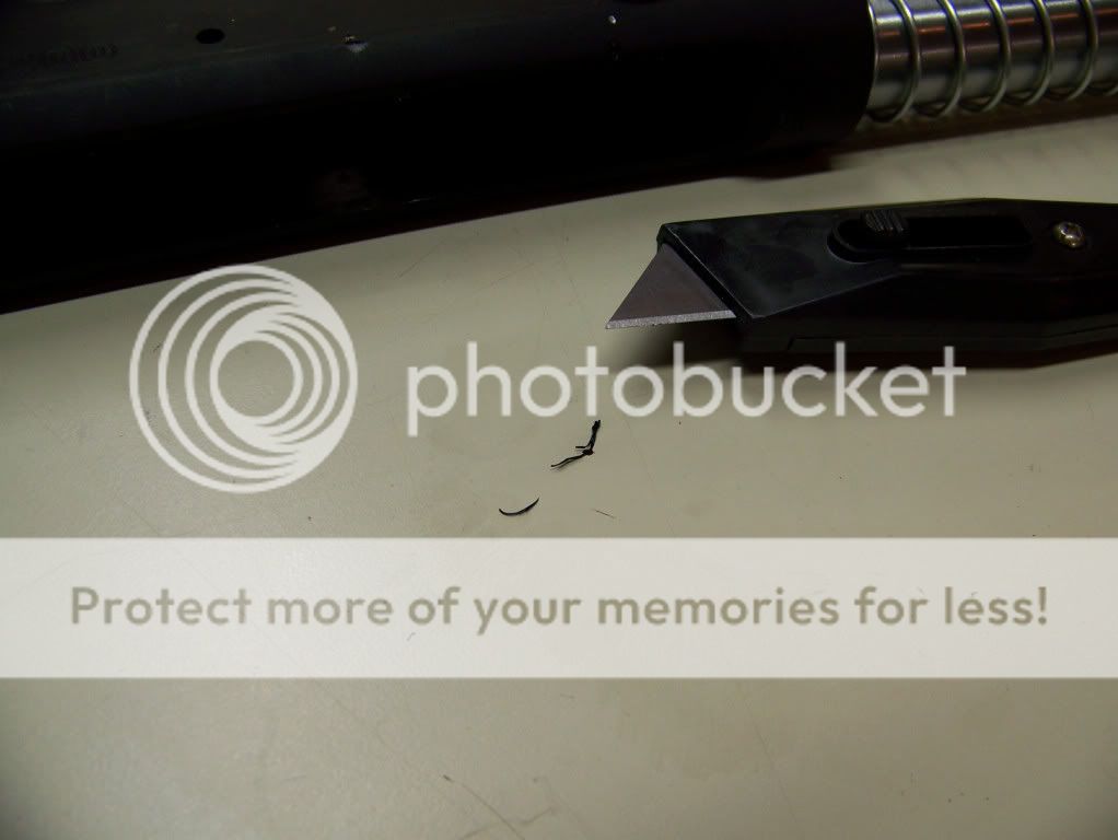

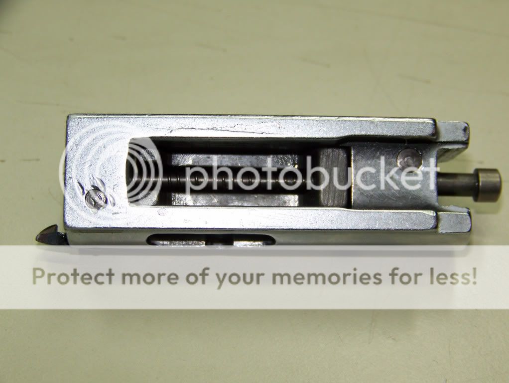

-The gun is internally rough... lots of machining marks and burrs

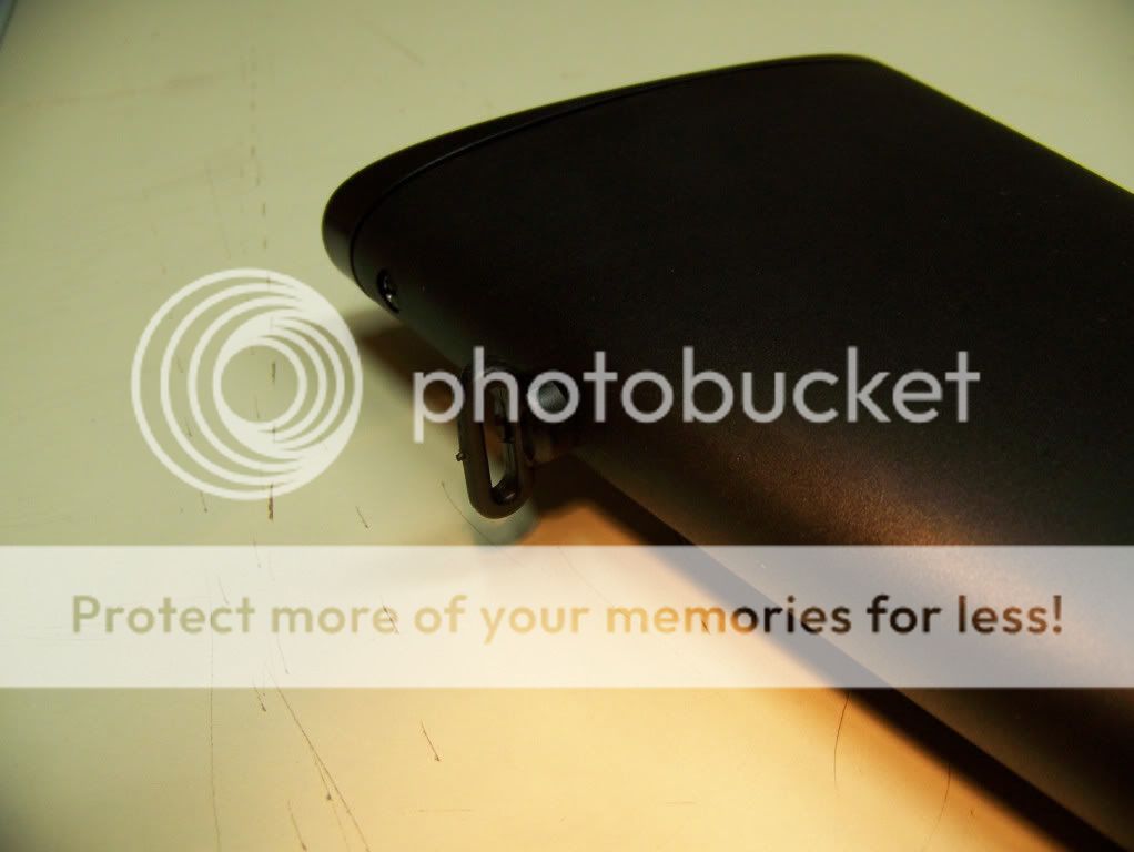

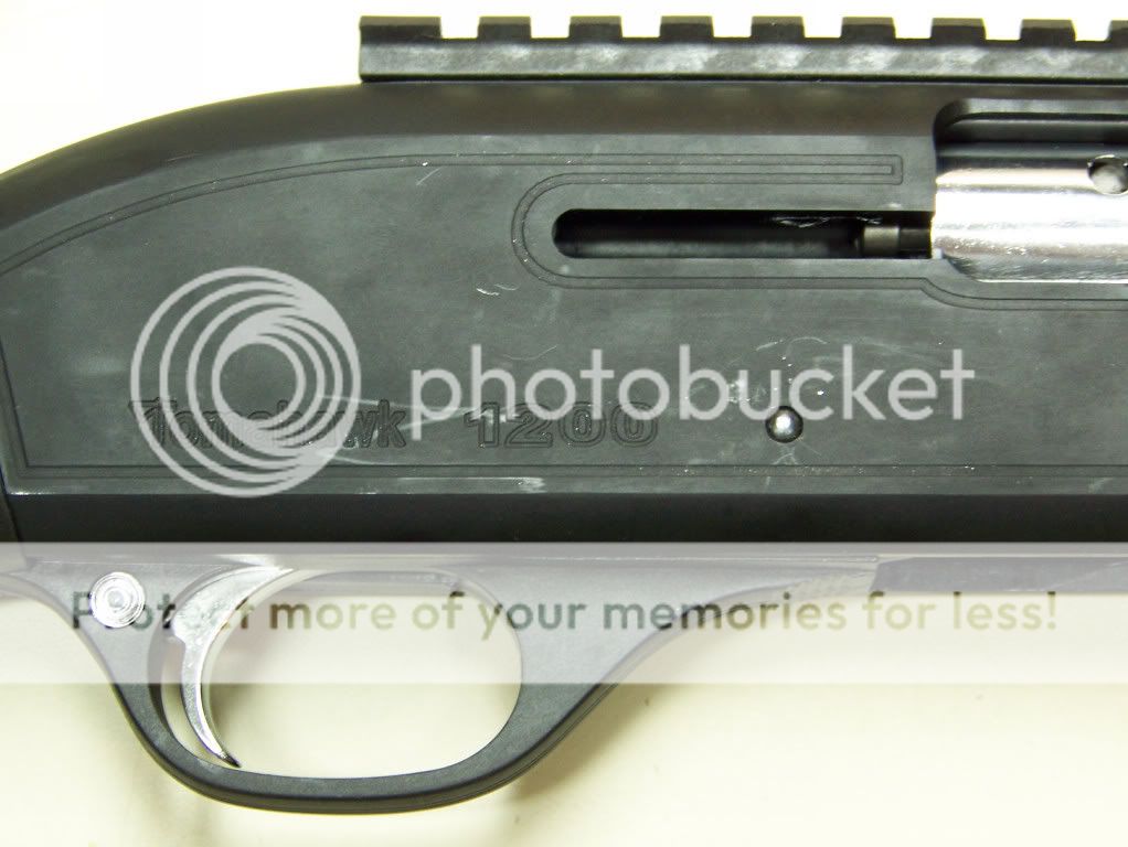

the gun came "factory equiped" with a few scratches on both side of the receiver...
this "z" shaped one being the most obvious
An other one on the pistol grip...

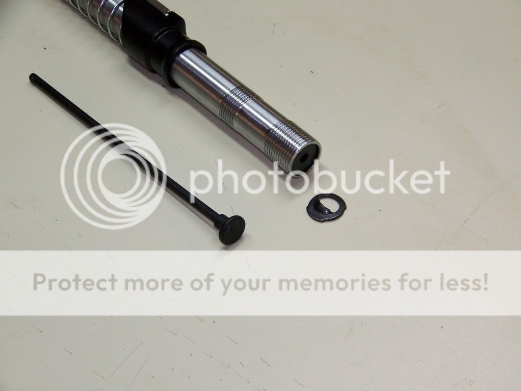

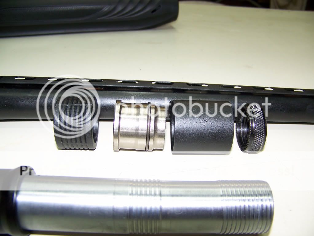

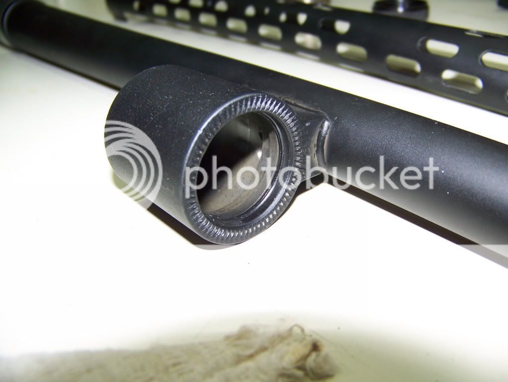

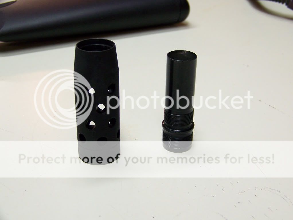

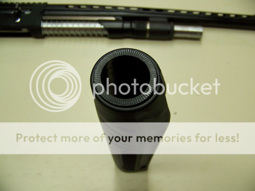

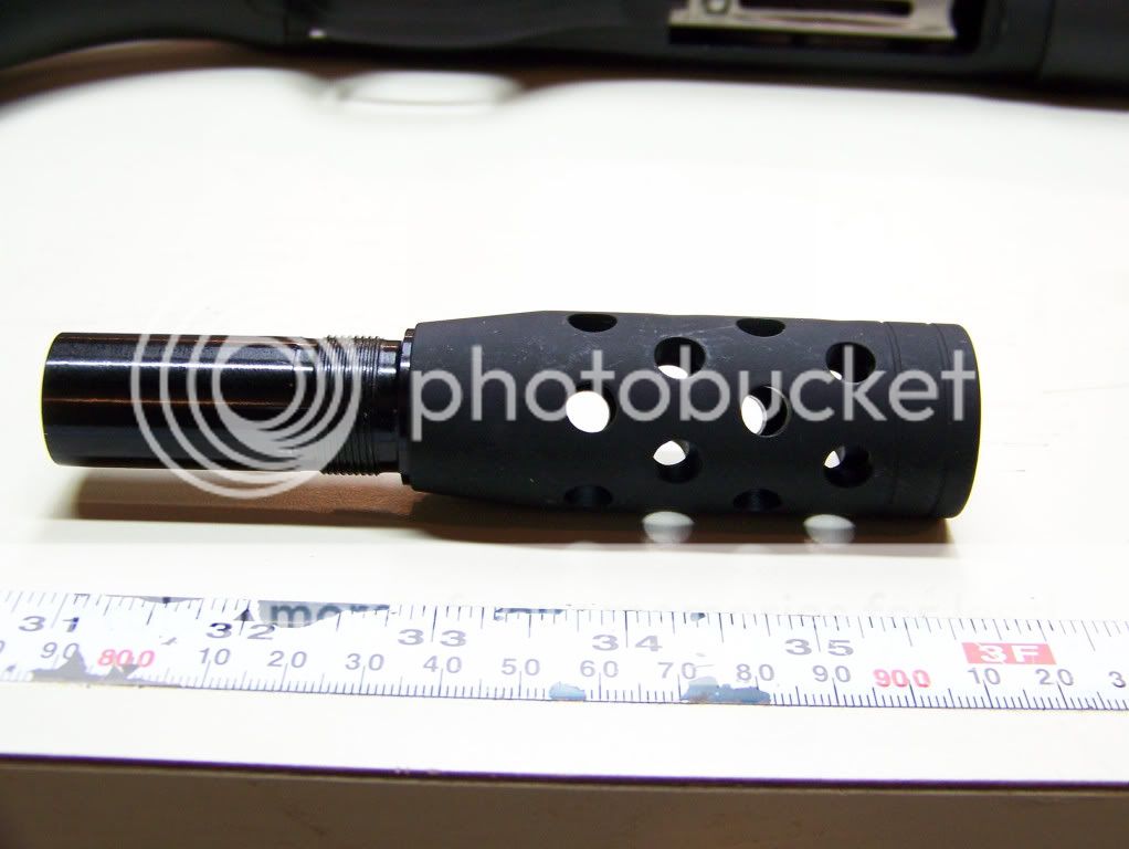

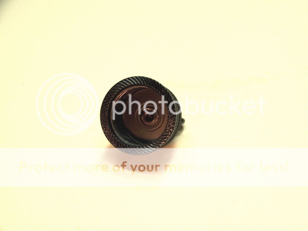

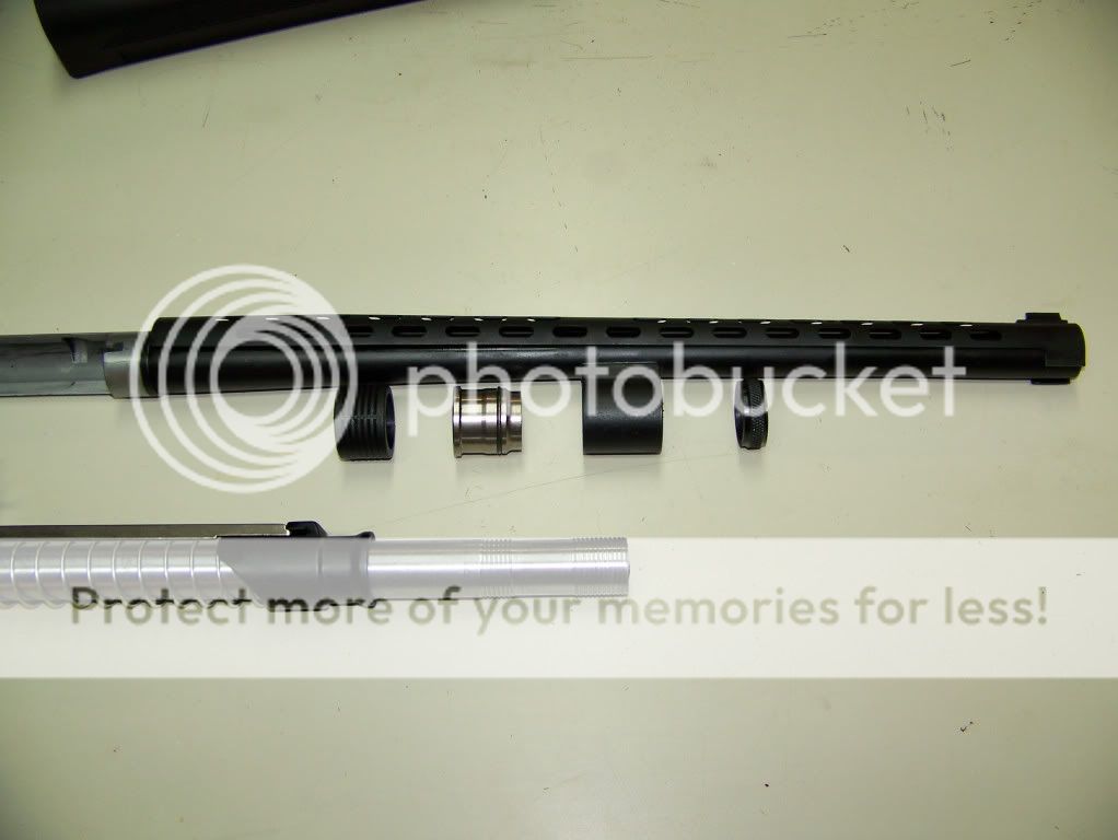

the gun comes with a big muzzle break and 3 choke tubes... the muzzle break is actualy a 2 pieces unit

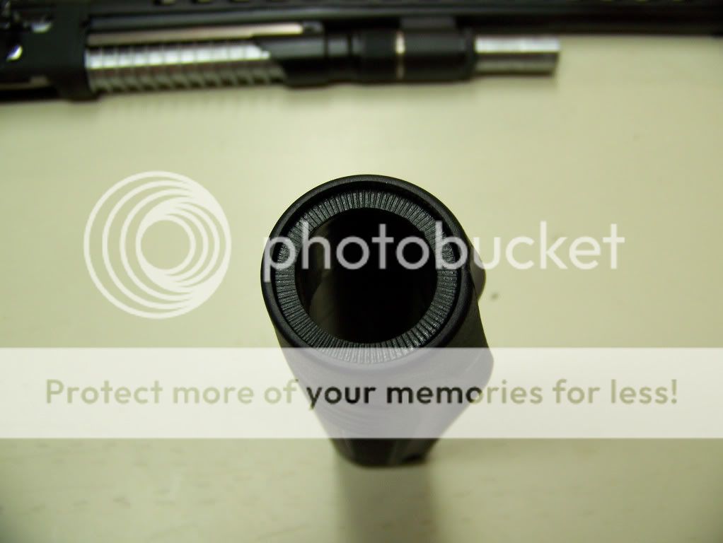

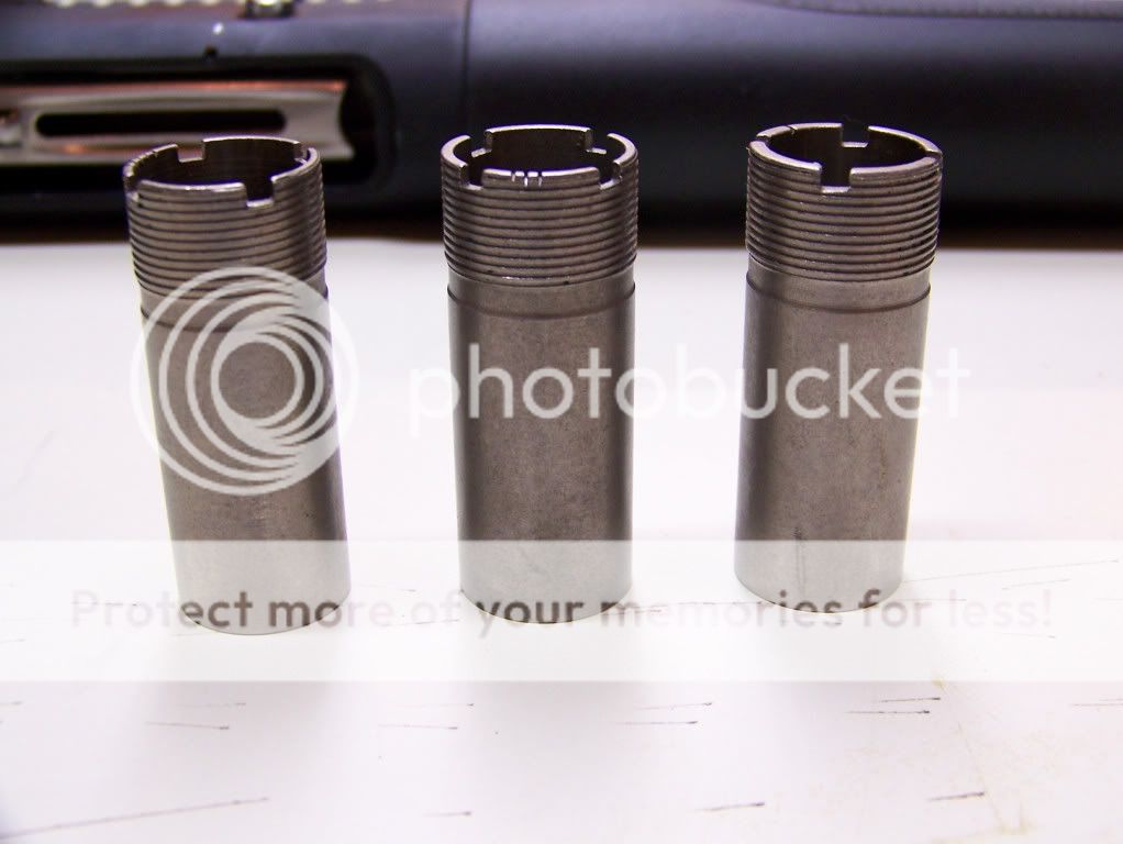

The choke tubes treads are rough and the notches even more...

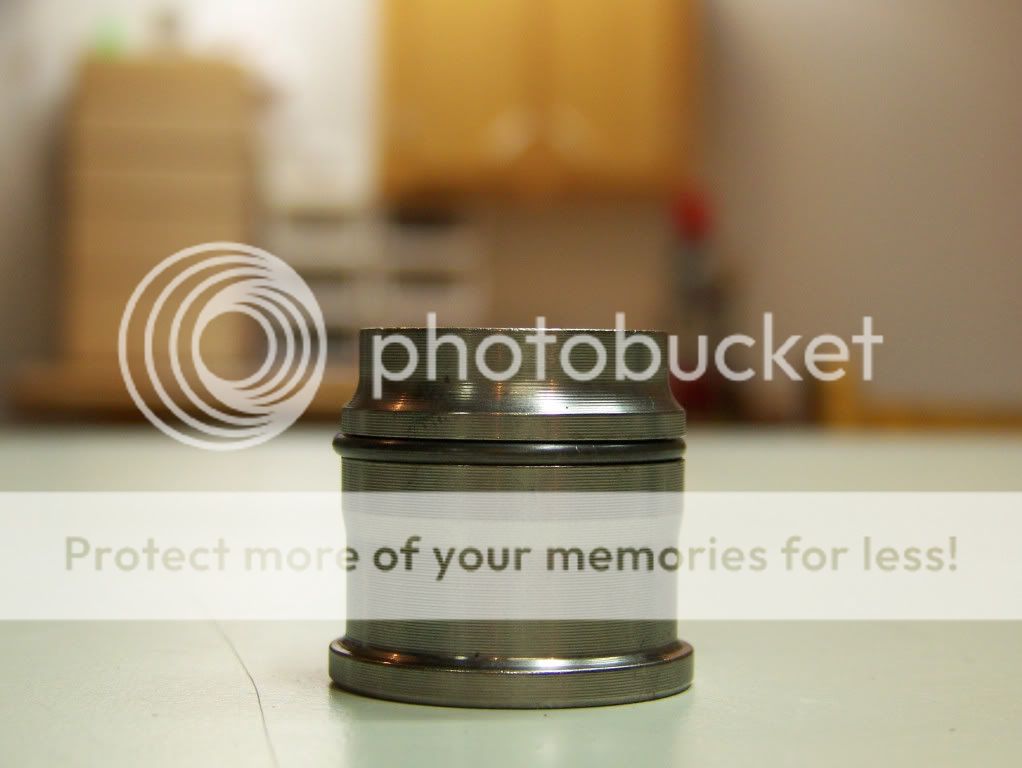

Tomahawk (Benelli type?) vs Mossberg choke tube...
One of them is badly machined, it does not screw all the way into the barrel

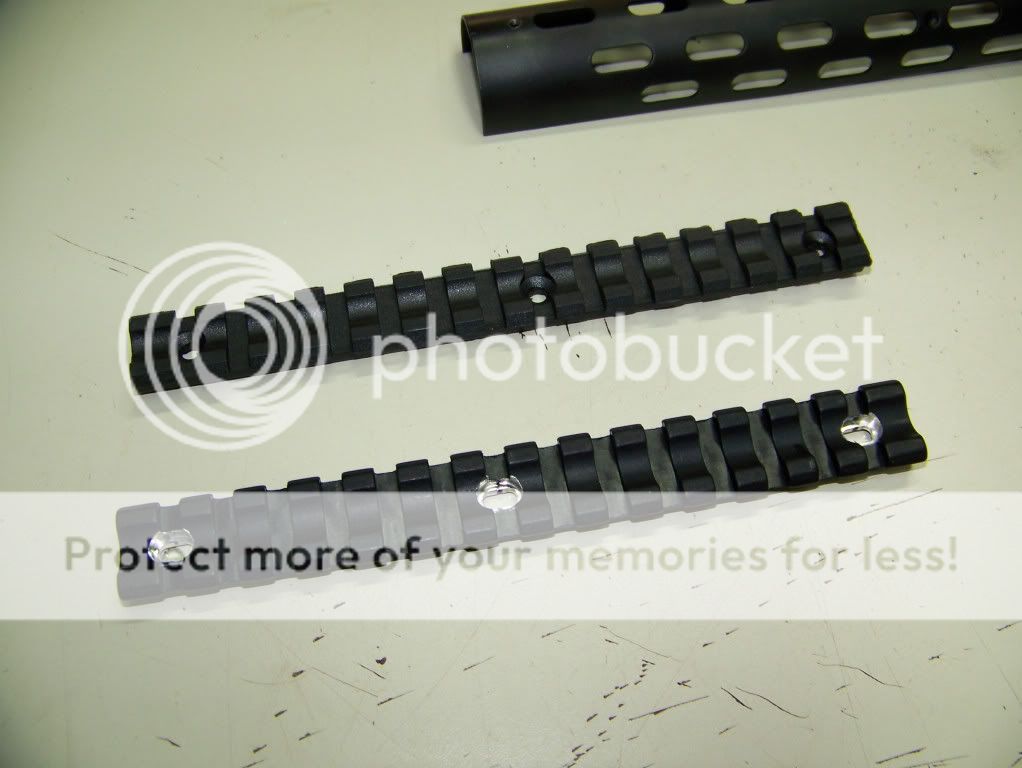

The gun is also supplied with a choke wrench, a user manual, two acc. rails (one already fitted on the receiver) and this notice from Marstar regarding those two rails

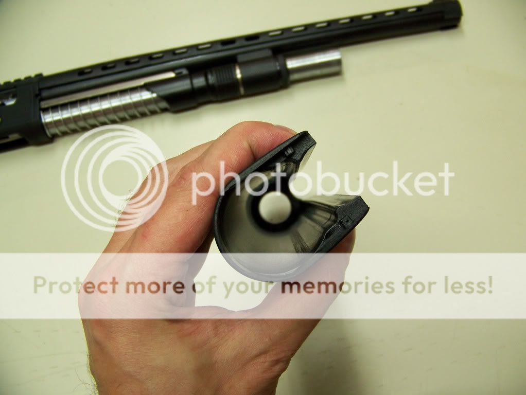

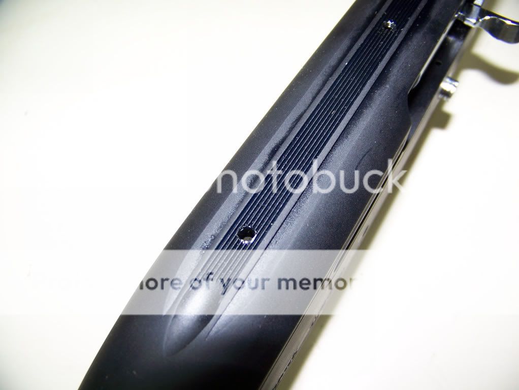

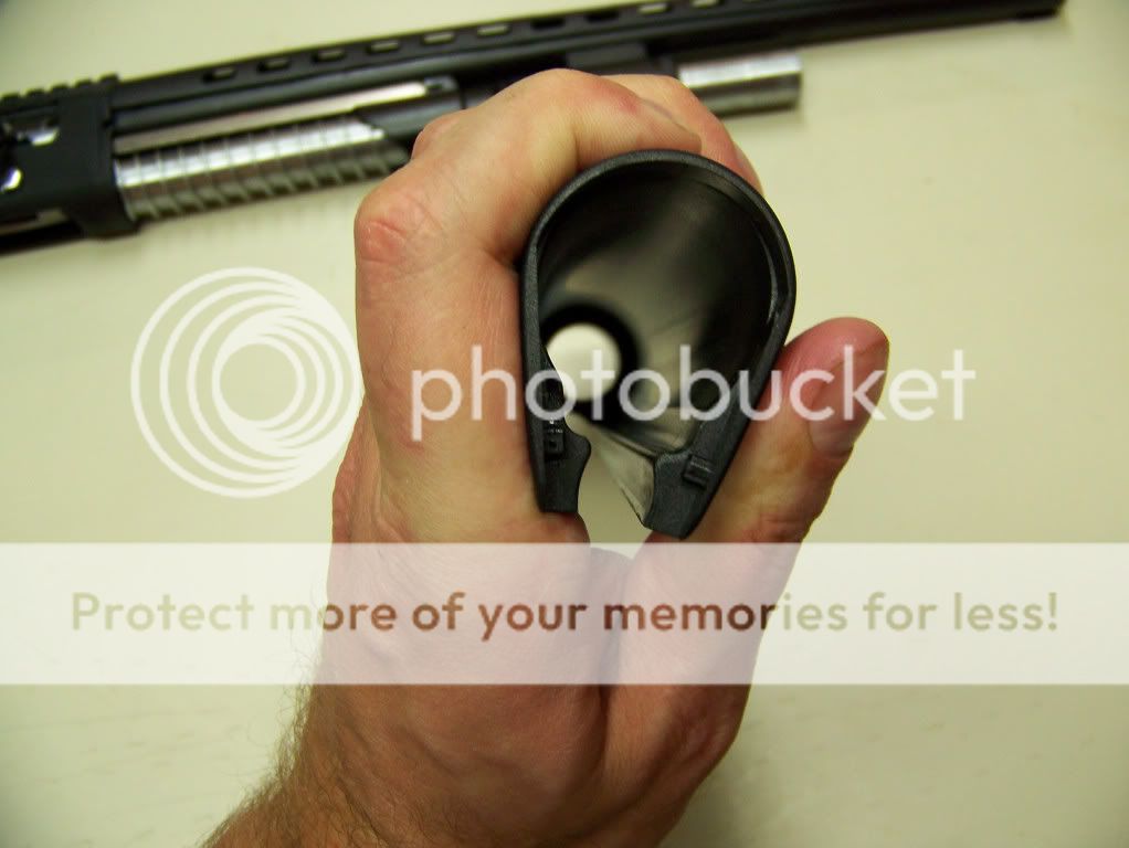

The first rail (The european one?) is actualy a banana shaped piece of very soft plastic...it is honestly the first time I see "something" like that on a firearm

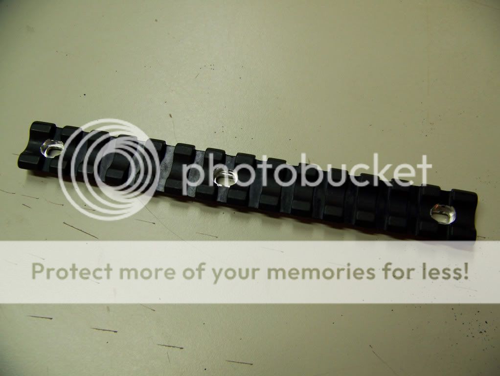

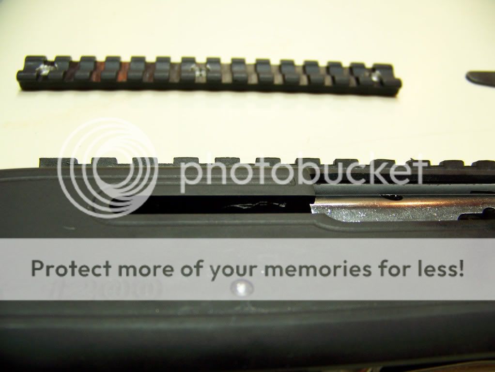

The other supplied rail is is molded (not milled) out of aluminum...
Here are the two rails side by side

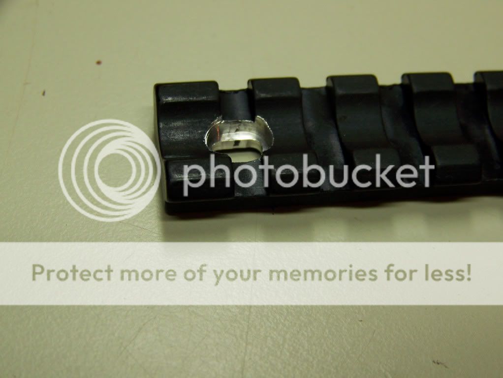

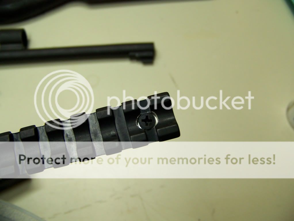

As you can see here, someone made some final ajustements to the aluminum rail "after" the final painting
Deburring the holes was obviously not part of the process...

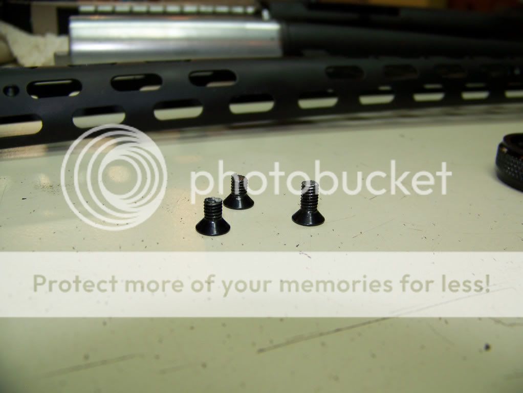

the supplied mounting screws are not helping much in the look departement...the new holes are not conicals and they don't match the screws very well...
it's a sad thing because, as you can see, they were carefully cut to lenght by a turkish artisan

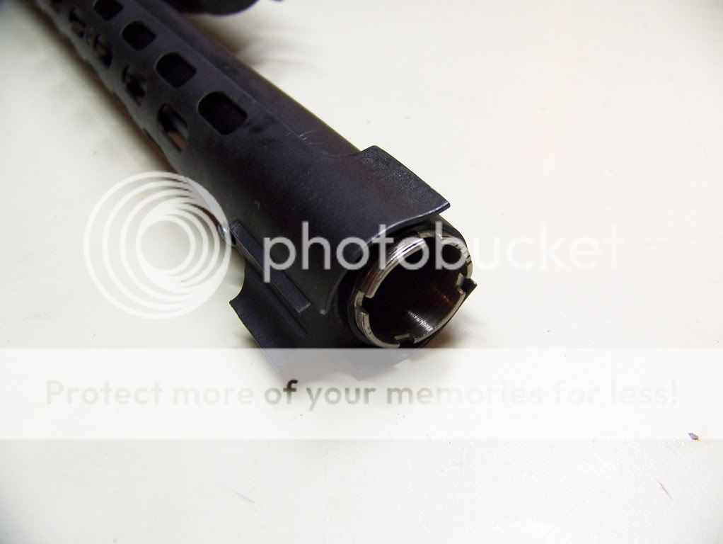

The use of the rail was not in my plans anyway so it's not a big deal for me...but nothing was supplied to plug holes in the dovetailed
receiver (std #8 set screws would probably fit)
the coating on the receiver and the barrel doesn't look very tough... it scratches very easily
the bolt release button, trigger safety button and bolt are chromed...like kitchen appliance... lol ...not really tacticool
but the finish seems tough...
