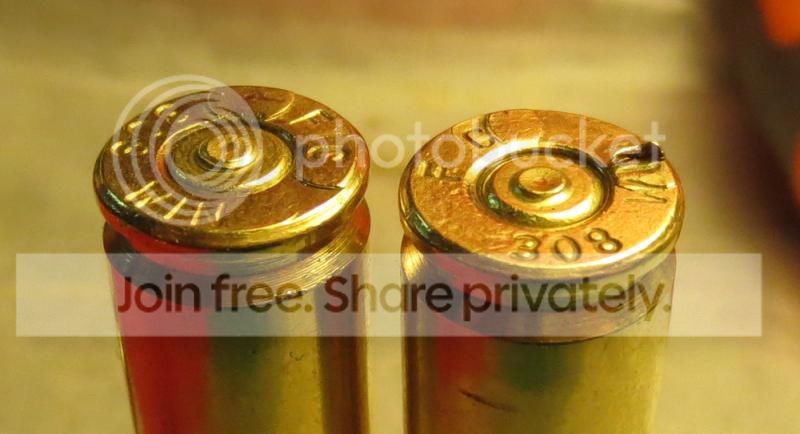

I find it curious that the two ejector marks be so equally spaced between the two cases.
I do however note that a factory FC case would have red or blue lacquer around the perimeter of the primers.
If it was a factory ammo issue we would probably have 4 or 5 new threads on here about Federal Crap ammo. This leads us back to either gun or improper reloading practices.
As noted there seems to be no case bulges or apparent web exposure to indicate a poor semi lock up or an oversized chamber.
The leaking, flowed primers and yet radiused perimeters is perplexing.....If a primer were (red/green) loctited in place (excess wiped clear) and the case over pressurized could the radius be preserved whilst flowing the primers base into the firing pin hole?
If starting pressure loads were being used and an oversized primer pocket was used simultaneously could this occur? I personally have never finger seated primers before so can only guess. I will say that I have tossed a number of FC brass after the first (factory) firing.
Was there significant sooting of the case necks and shoulders prior to cleaning?
I wonder how the cases measure up dimensionally to 308 chamber specs?

I did originally think it was just a pressure issue but there are signs that it is something else. Glad I could spur some discussion and theorizing; helps increase my own understanding of these things.
You can take it from an expert on pressure signs in brass, these photos are not from a high pressure related problem. The primer will ALWAYS flatten in an over pressure condition. I have also experienced low and moderate pressure headspace situations and the primer is again flattened somewhat as it is reseated after initially popped out from excess headspace. In my opinion this is an extremely soft brass problem, whereas the brass is flowing before the primer cup is even flattening. Could be an over annealing situation or just garbage FC brass, accompanied with a rifle with some serious boltface issues.

Yes, I stated in post #8 that the primers indicated it had been a very light load.
The whole case having been annealed makes the most sense to me, but really doesn't explain everything.

It may not be pressure.
I've never seen blanked primer strikes and prominent ejector marks without flattened primer edges as well.
I'd agree with that synopsis. Also something not right in the boltface.
