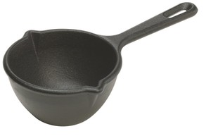

As I said, total beginner and probably going to remain very occasional.
Any problem with using one of these 14 oz cast iron melting pots, outdoors only, to melt lead for pouring into molds? When I was a kid, I did it with soup cans but I want to fancy up.
Nothing wrong with it as long as you can live with lead spills, mind you, over time you can probably get good enough that you won't have any.
I use something similar in my wood stove to process my pewter and any small amounts of stick on weights I get. Good for casting ingots.
Personally I would get some kind of small ladle from a thrift store for pouring into the molds, using the cast iron one for melting the lead and keeping it warm.
I found when melting down wheel weights that I end up with a lot of crap in the container - lots floats to top, but lots still stuck to walls. I have tried various "fluxes" but plain fine saw dust seems to work as well as anything, seems to work best if mixed into the lead melt. All this scraping / mixing means whatever container you use has to be set up quite stable, beside just the weight of the lead, you are also going to be "working" it. I would think your melting pot would work well - nice to have a handle and a pouring spout, but check how stable it sits on your hotplate or heat source. Just because the saw dust seems to work, I have a selection of "kindling" sticks that I use as my "stir stick / scraper", then a big spoon with holes to dip off the "grunge" that comes floating up.
Used to use one as a melting pot only, far too heavy and awkward to pour from. Also slag is on the top always gets in the way. I used an old school metal gravy ladle as a dipper and to pour from, held just over 1 oz, Used for Lee slug molds. Moved on to electric bottom pour pot style now for casting. Still use cast iron pot for melting and cleaning up used lead though.
Just re-read your post - 14 ounce for pouring into moulds - don't think that is such a good idea! Too big, therefore too heavy to have much control!! As above, a real "ladle" works best!! I think you will find that you want your "pouring" technique to become very repeatable - change how you pour and the bullets come out differently!!
And I would get something bigger to melt a batch in like a big pan or Dutch oven at least.
That way you only have to melt ingots occasionally and you have consistent ingots (so same hardness etc.)
Personally I'd opt for a bigger pot to melt and definitely get either the RCBS or LYMAN LADLE to do the pour. The pot you show would be too heavy and hot to handle for long. The LADLES are wonderful to use, very controlled pour.

Unless you have a contraption to hold your pictured cast iron pot over your heat source, I would switch to a broad flat bottom pot. It doesn't have to be cast iron either. A good, reasonably thick, deep steel pot with a lid will do.

Have to agree with the guys recommending a flat bottom pot, the one you show in post #1 looks like it would have to be held while heating up. An old dutch oven would be my first choice.
