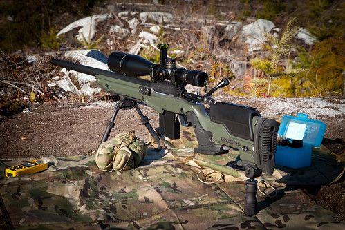

my short action is in a JAE 700 but that whole build was put together with weight being the lowest concern. The rifle weighs close to 20lb with almost half of that due to the 28" Hvy Varmint barrel. This project is to go the other direction with weight being a major focus
IMG_3006.jpg by ceriksson, on Flickr
